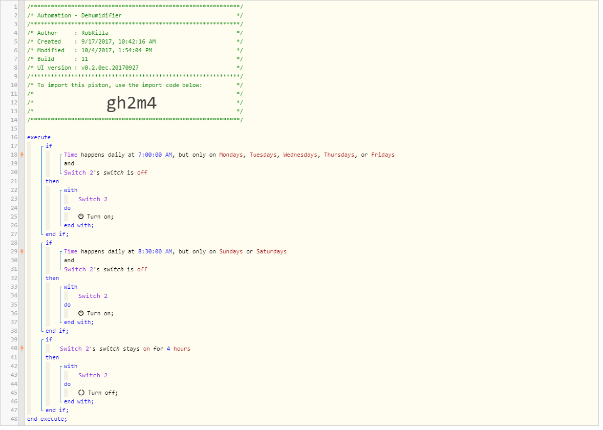

Piston schedule days and time not firing as expected

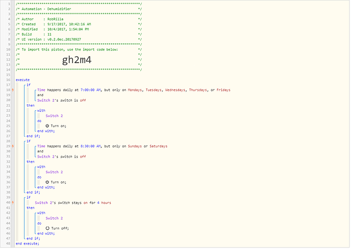

I have a piston set to turn on an outlet M-F at 07:00 and Sa-Su at 08:30
In addition, the outlet is on for 4 hours, turn off the outlet
The piston fires and turns on the outlet M-F at 07:00 and Sa-Su at 08:30 and if the outlet is on for 4 hours, turn off the outlet
The piston is turning on the outlet at 07:00 and turning it off at 08:30

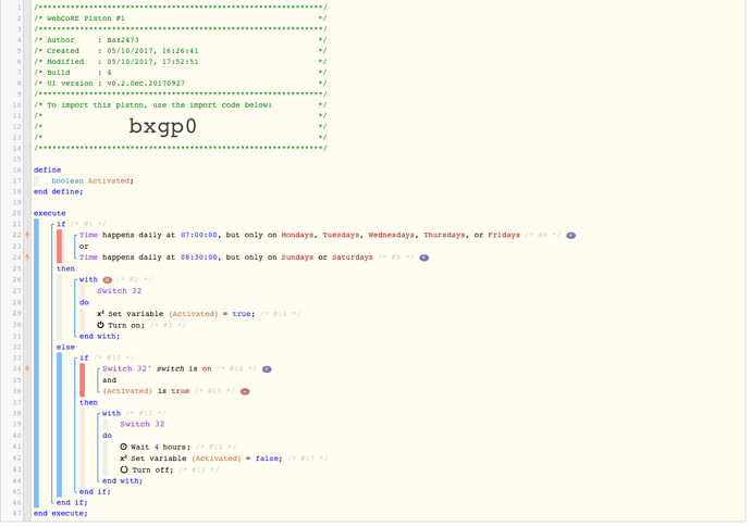

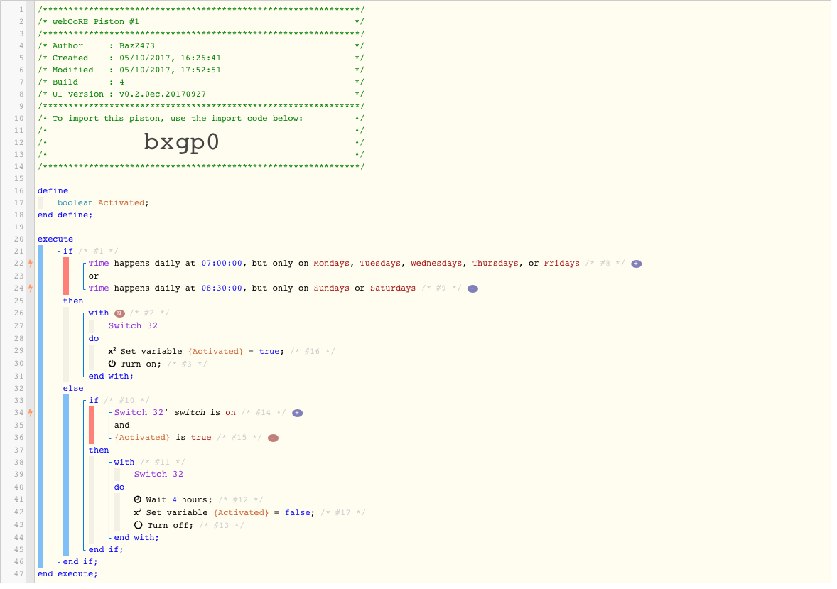

I’m not sure why it’s doing what you say, could have something to do with the structuring of the piston or the stays on for 4 hours condition?
Are you wanting the outlet to turn off if it’s been left on for 4 hours regardless of if it was turned on by that piston or via any other means?
Or are you only wanting it to turn off after 4 hours if it was turned on ONLY by that piston?
I’ll upload a differently structured version for you to try once I know how you want it to function, if that helps?
Thought I would upload both versions for you anyway.
This one “should” Switch off the outlet after 4 hours no matter how it was switched on.

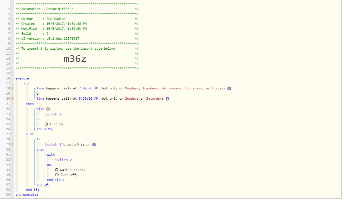

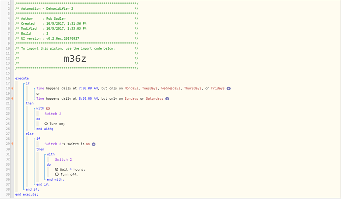

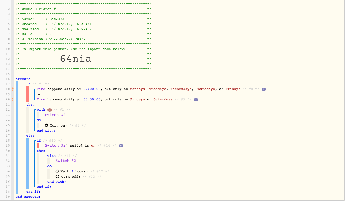

This one “should” switch off the outlet Only if it was switched on by this piston.
Thank you for the examples. I was looking for OR and couldn’t find it.
I’ll mark as answered but I’ll try it out.
Kind regards,
-Rob
Quick note on this. When I imported the Piston, the logs still show it will wake tomorrow at 08:30 which I wouldn’t expect to see.
I’ll try it out though. Looks much better than my Piston did :slight_smile:

You have it set to turn on the outlet at 07:00 & 08:30
That will cause the piston to fire at both times but because there is a day restriction it will only execute the then command if the day is correct. So the logs should still show it scheduling an event for 08:30 but it should evaluate as false because it’s not Saturday or Sunday.
And is the default but if you click on the word “and” in the piston editor you can change it. :grinning:
@Baz2473 - Quick follow-up, everything is working great. I’ve also recreated some of my existing pistons based on the examples you provided.
Thank you so much for the quick and accurate replies!
-Rob
