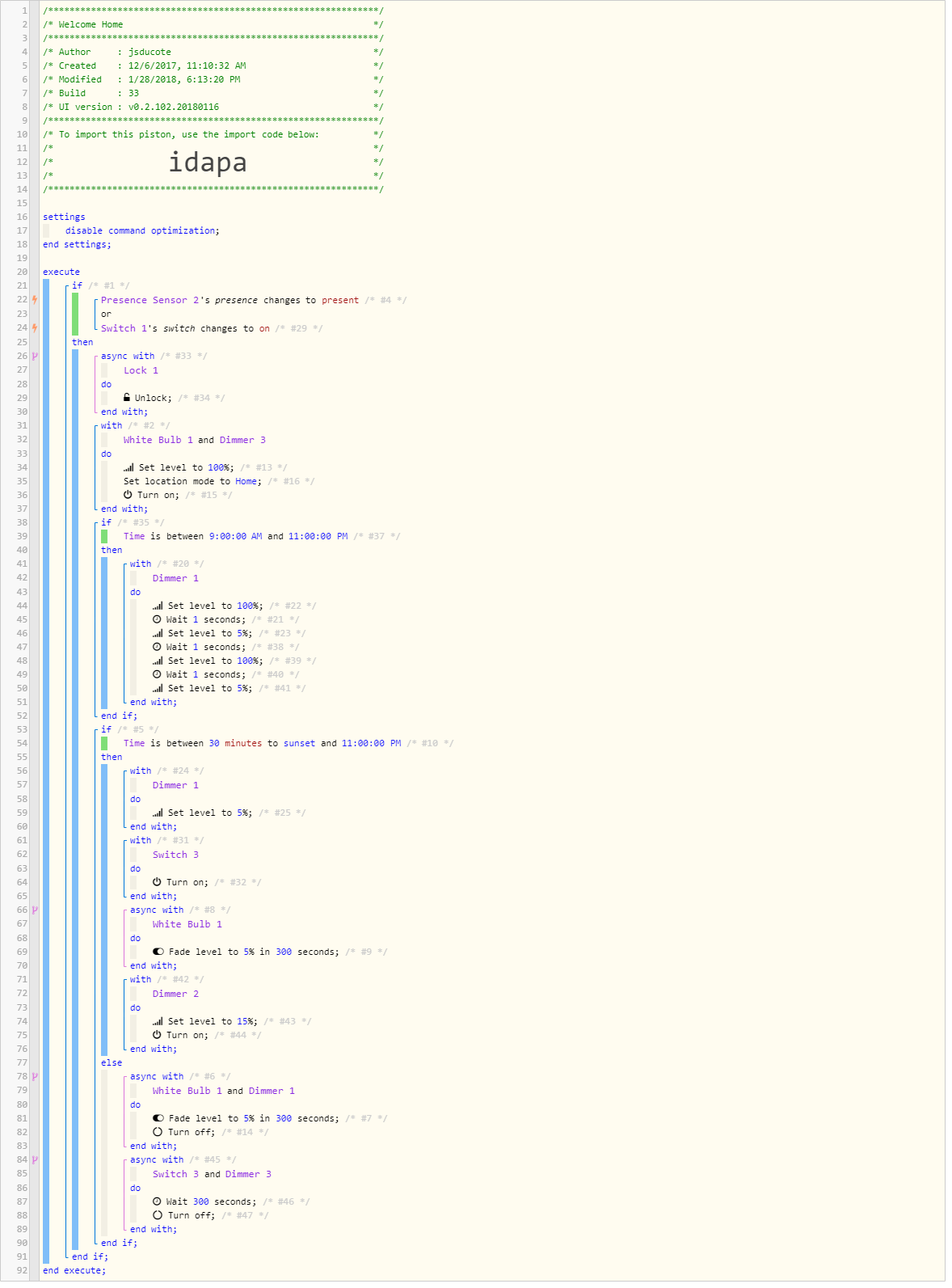

Like everyone else, I have a piston to turn on lights when I arrive home. Usually it works just fine. Today, portions of the piston selectively executed.
Set level and turn on commands are sent to four lights, and I expect that they will actually turn on. Two of the lights then fade to 5% and, depending on the time of day, either turn off or stay on until bed time.
Command was sent, light did not come on. In the app, if I look at ‘recently’ in the app for those lights, I see that they were sent the commands. Unfortunately, I was still standing in the dark. The lights responded to a manual command from the app to turn on and command via Alexa to turn off. You can see in the log that at +380ms, commands were sent to two of the lights. The lights chose to ignore the commands? At +4151ms, the fadelevel command was sent to one of the lights, but it did not result in any action and subsequent fades (99, 98, 97, etc.) were not scheduled or sent.

I think I solved my own problem.
Dimmer 3 (aka “pendants” in the log) is an Inovelli-brand 3-way dimmer. The switch is new and I recently added it to this existing piston. Although new, the switch does not respond to being set to 100%. White bulb 1 is a Lifx and has no problem with 100%. These were the two lights that weren’t coming on. Since they’re part of the same WITH, when one failed it caused them both to not respond. I updated the piston to set level 99 and it works fine, including the fade for WB1.
Buyer beware - Inovelli dimmers (mine at least) max out at 99.
