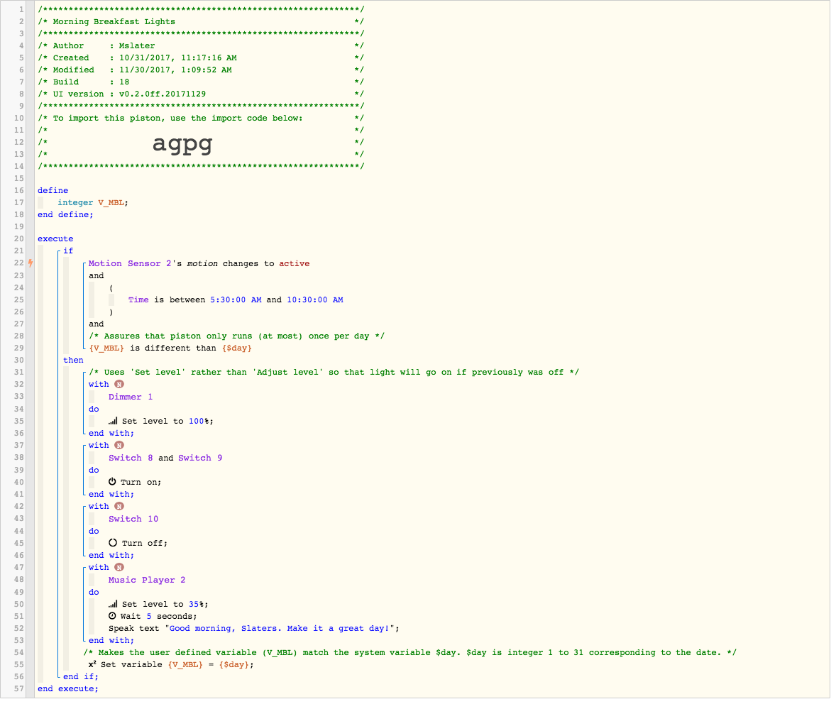

Not sure what I was thinking or how I did this, but what is “Never Cancel” which shows as the “N” icon? Do I need it, and if not- how do I get rid of it?

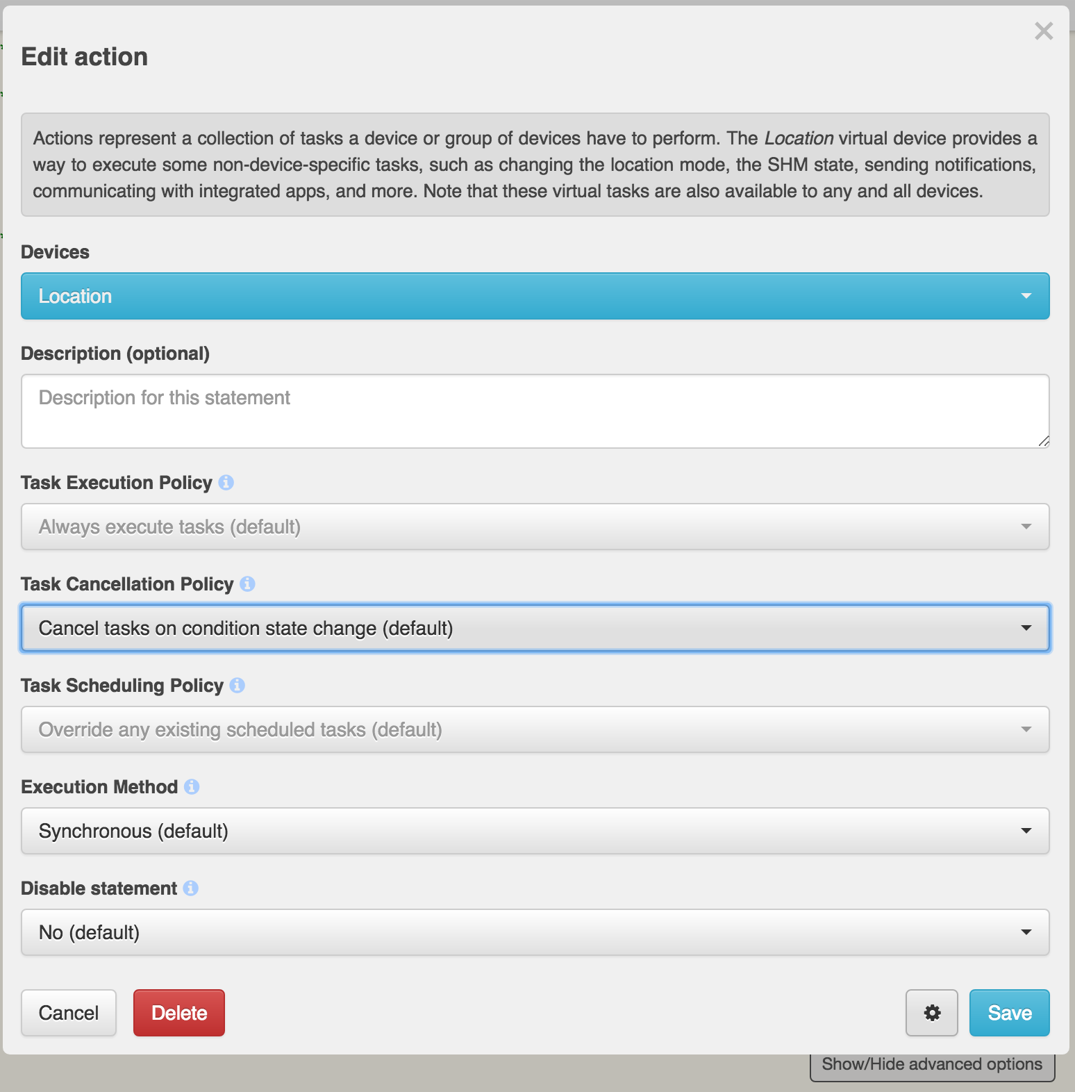

you need it on the last with block as shown in the snapshot. for the other with blocks click on them and turn it off under options in the pop up window.

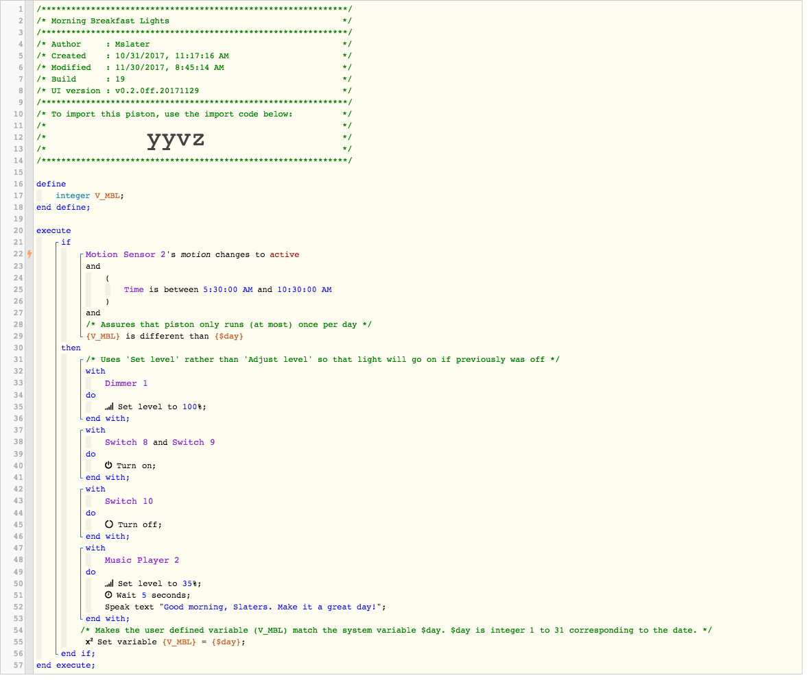

Thanks @bangali- I’ve now removed the “N” from all IF blocks except for the IF block which changes the variable (last IF block). It’s not showing on this pic, but is this right?
For knowledge and future reference, can you explain to me what this is and why/when it would be needed? That would be really helpful. Thanks!
yeah somewhere in the corner of my mind i knew i should have clarified this more. thats probably why i wrote it this way:
so the last with block that sets the variable does not need it. the last with block as shown in the snapshot which has the wait statement needs the TCP set to never.
