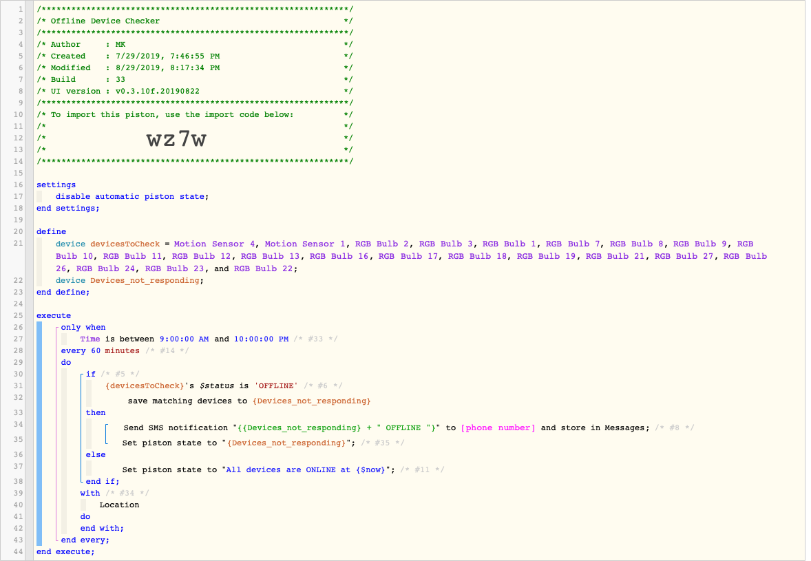

Maybe I’m misunderstanding Piston State, but I have a “check for offline devices” piston that works great. However, I ask that it update the Piston state to said offline devices, but it only ever seems to mention two old devices.
I expect the piston state to show the offline devices.
The piston state shows: Porch L and Porch R offline. But I no longer have “Porch L” or “Porch R” lights - I had to reboot the lights and now call them Porch Left and Porch Right (and they are online).
I have enabled automatic piston state, then disabled it but the ghost devices still show.

The command:
Set piston state to "X and Y OFFLINE"
is found nowhere in your code.
It must be old and lingering from an earlier edit. As soon as the new code processes correctly, it will update the Piston state with either
  • Devices_not_responding (line 35) or
  • All devices are ONLINE at 10:00PM (line 37)
(pushing Test will not do anything with this piston)
Pro Tip:
You can speed up your testing by temporarily reducing line 28 to 2 minutes while testing…
Yes, it’s all correct now. - thanks!! I’ve had this issue for a week now but only enabled/disabled automatic piston state tonight. Maybe that “reset” things? Speeding up the test let me see the piston state is updating correctly now.
