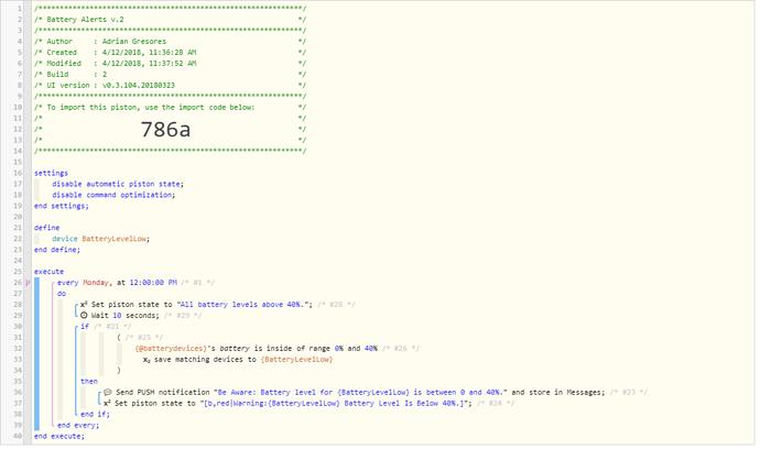

Piston state not changing, despite actual conditions changing
When all battery levels > 40% as per ST app, piston state should change to “All battery levels above 40%”
Piston state not changing.
4/12/2018, 11:38:05 AM +414ms
+0ms ╔Received event [Pepper Bush].test = 1523551085413 with a delay of 0ms
+68ms ║RunTime Analysis CS > 12ms > PS > 29ms > PE > 28ms > CE
+72ms ║Runtime (44473 bytes) successfully initialized in 29ms (v0.3.104.20180323) (70ms)
+72ms ║╔Execution stage started
+78ms ║╚Execution stage complete. (6ms)
+80ms ║Setting up scheduled job for Mon, Apr 16 2018 @ 12:00:00 PM CDT (in 346914.507s)
+87ms ╚Event processed successfully (88ms)
