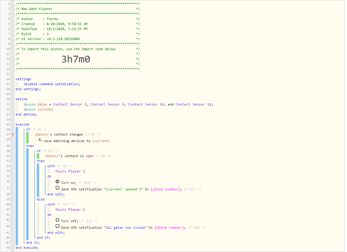

Piston stopped one notification, not sure why
My piston stopped notifying me when a gate is shut. Last notice of “all gates closed” was Wednesday.
I get a notification when any gate is opened, with which gate, and a notification when all gates are shut.
I get the proper gate opened notice, but I do not get the “all gates closed” notice. All my gates are closed, and show in SmartThings as closed.
These two log entries are from a short while ago - I opened, then closed, a gate.

It looks like the piston believes the second gate in the list is open.
Heh yep. It’s smarter than I am. One of my sensor’s batteries died.
