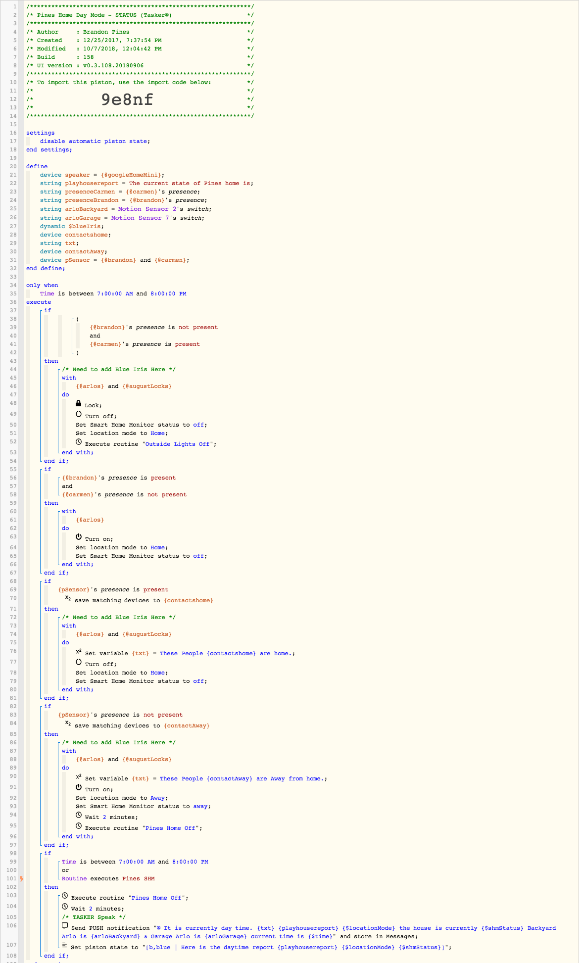

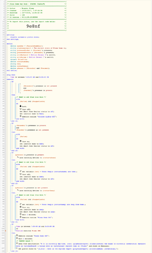

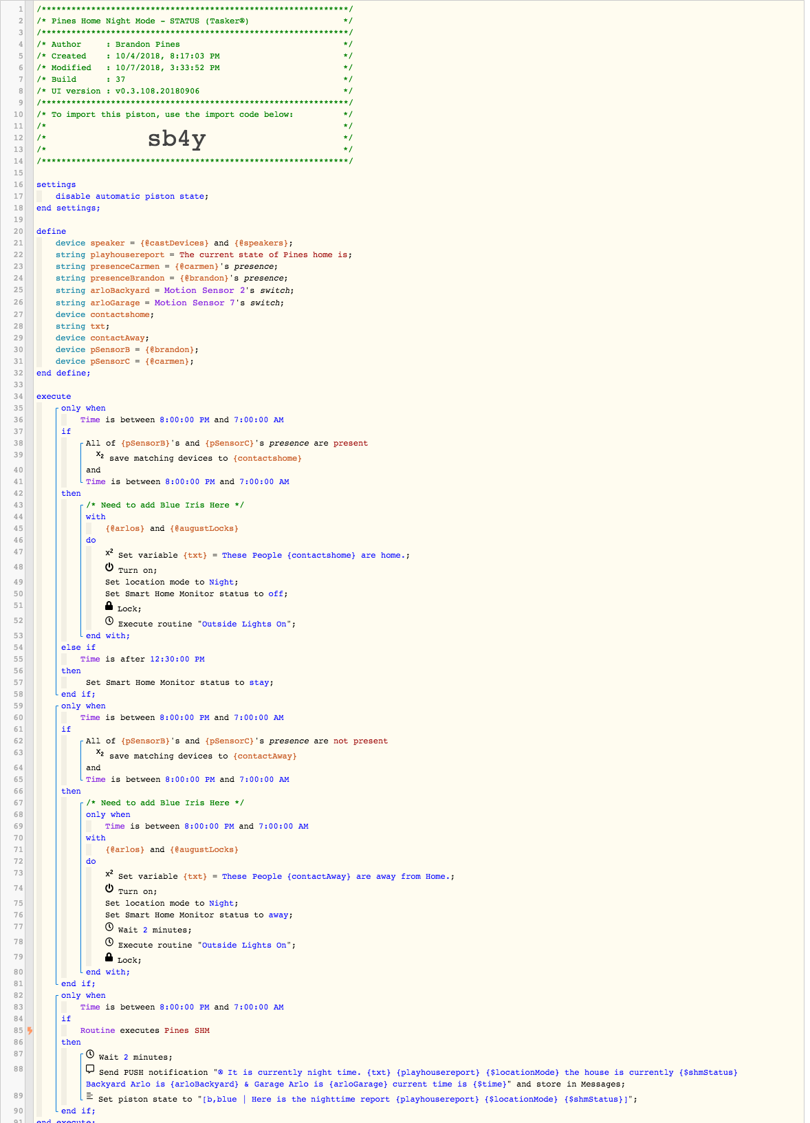

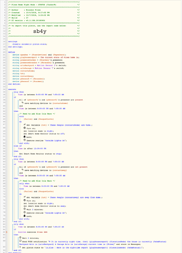

Piston Tile is not consistent
I have two pistons - Day and Night mode. The Piston Tiles are not matching.
…Also I had an issue that the pistons were running over and over and the night piston was running during the day. I know this because in the push notification i added daytime and nighttime so i can see which piston was reporting.
So I added the restriction to only run on condition change. Now they run only when presence changes or the virtual device is pressed but the night piston is still not saying False after I added teh time restructions.
and
Day to show day (home or away) + SHM when it is day (before 8pm) and night to Night mode (or away) + SHM when it is night mode.
Pines Home Day Mode - STATUS (Tasker®)Here is the daytime report The current state of Pines home is Night Armed/Stay PauseTestView
Pines Home Night Mode - STATUS (Tasker®)Here is the nighttime report The current state of Pines home is Home Disarmed

###Night Logs
10/7/2018, 3:51:40 PM +735ms
+1ms ╔Received event [Casa de Pines].routineExecuted = 77ef3825-ef05-4710-bb46-be98f9437a9f with a delay of 118ms
+273ms ║Runtime (58840 bytes) successfully initialized in 203ms (v0.3.108.20180906) (271ms)
+274ms ║╔Execution stage started
+335ms ║╚Execution stage complete. (60ms)
+336ms ╚Event processed successfully (336ms)

Image of the piston(s)?
Edited post above.
