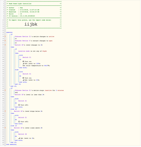

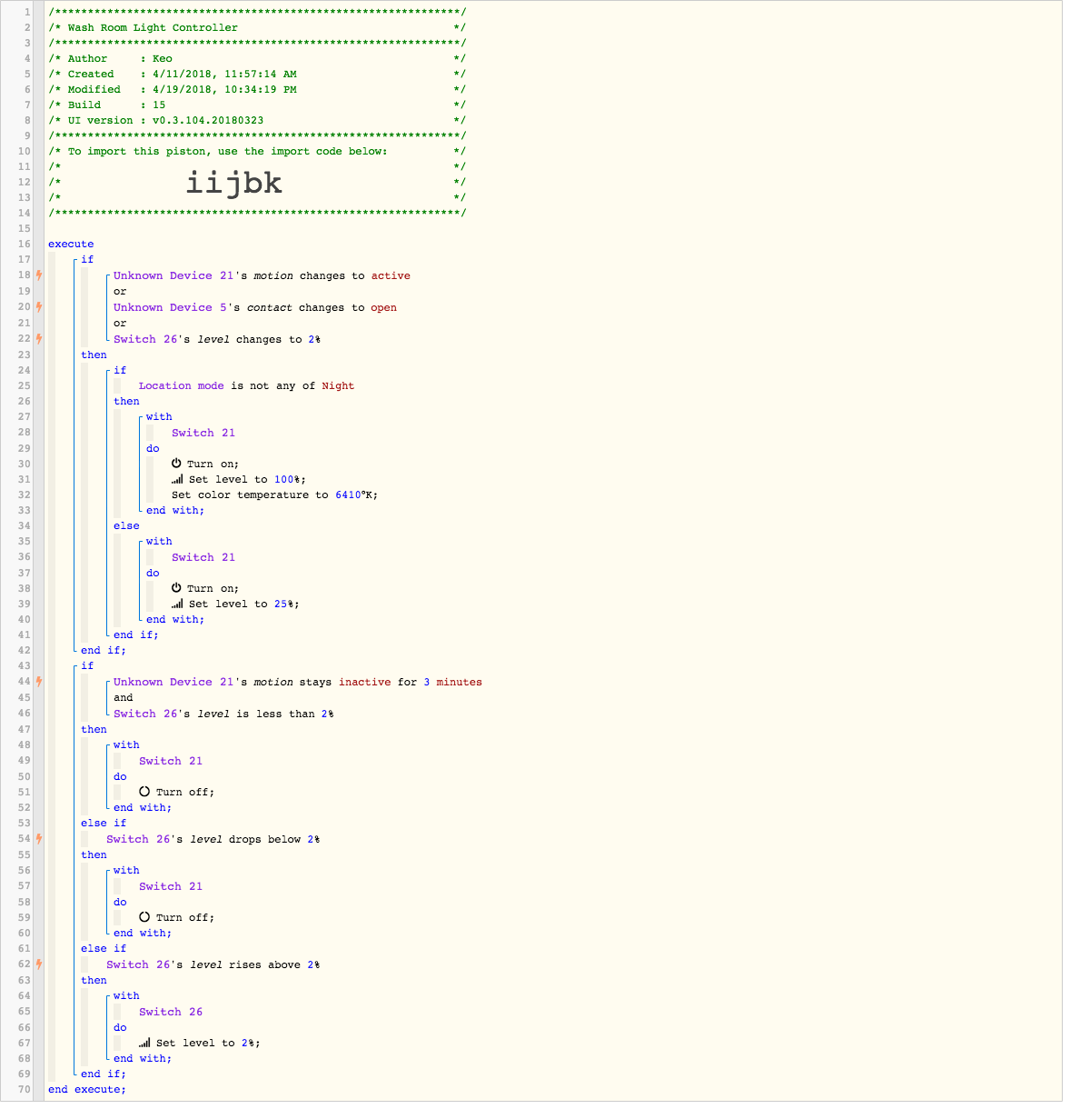

I created this piston and when my lights didn’t shutoff I went into webcore and saw that the timer for the lights was actually counting up instead of down. Full disclosure this is on the port of webCoRE over on hubitat.
I know it could be a bug over there, I just wanted someone to look at my piston to see if it’s a design problem.
lights would shutdown after 3 minutes
Lights aren’t shutting off.
Any time I have noticed my countdown timers going up instead of down, a simple refresh of the web page dashboard solved it.
