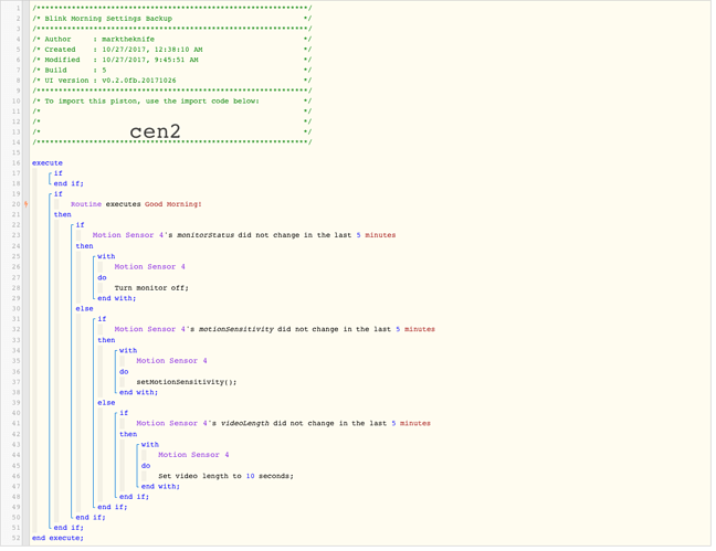

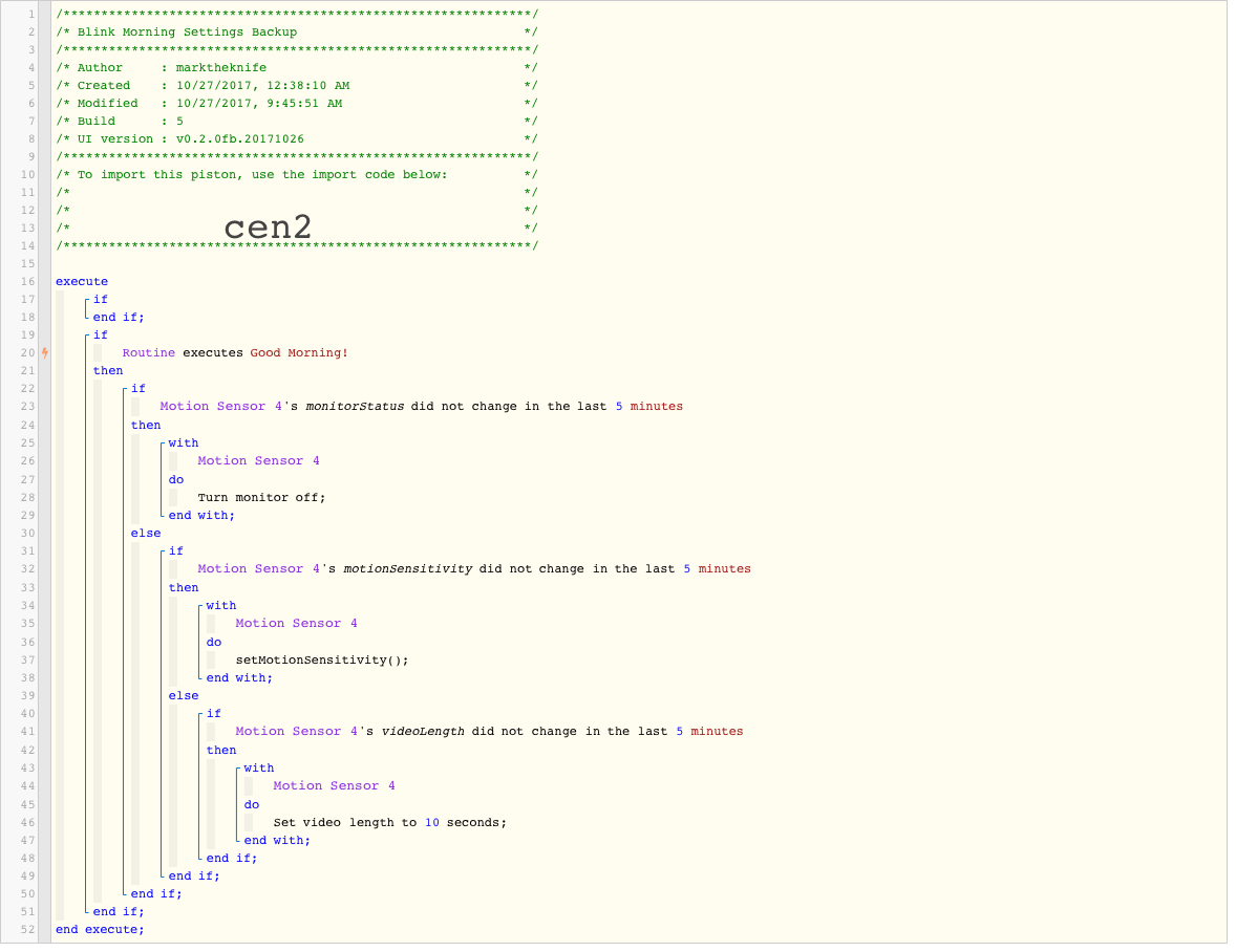

I’m sure I’m approaching this all wrong, I really don’t know anything about coding this kind of stuff beyond a very simple If-then statement. So any input is appreciated, and if it makes more sense to start over from scratch, that’s fine. Thanks!
4)
A couple things I notice.
The if statement on line 22-23. This will not cause a wait. Basically it is checking if the monitor status changed in the last 5 minutes.
You should add a new action above all these ifs to get a 5 minute wait.
You continually nest your if statements. So your second one will only check if the one before it was false and so on.
All the checks should be immediately in the then statement of the first if.

I realize that part of the piston is probably all wrong. I think what I was going for was something like
If routine runs
(and if monitor status hasn’t changed 5 mins later, then turn off monitor)
(and if motion sensitivity setting hasn’t changed 5 mins later, then set motion sensitivity to 7)
(and if video length hasn’t changed 5 mins later, then set video length to 10 seconds)
Clearly that’s not how it turned out though.

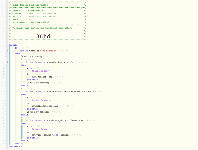

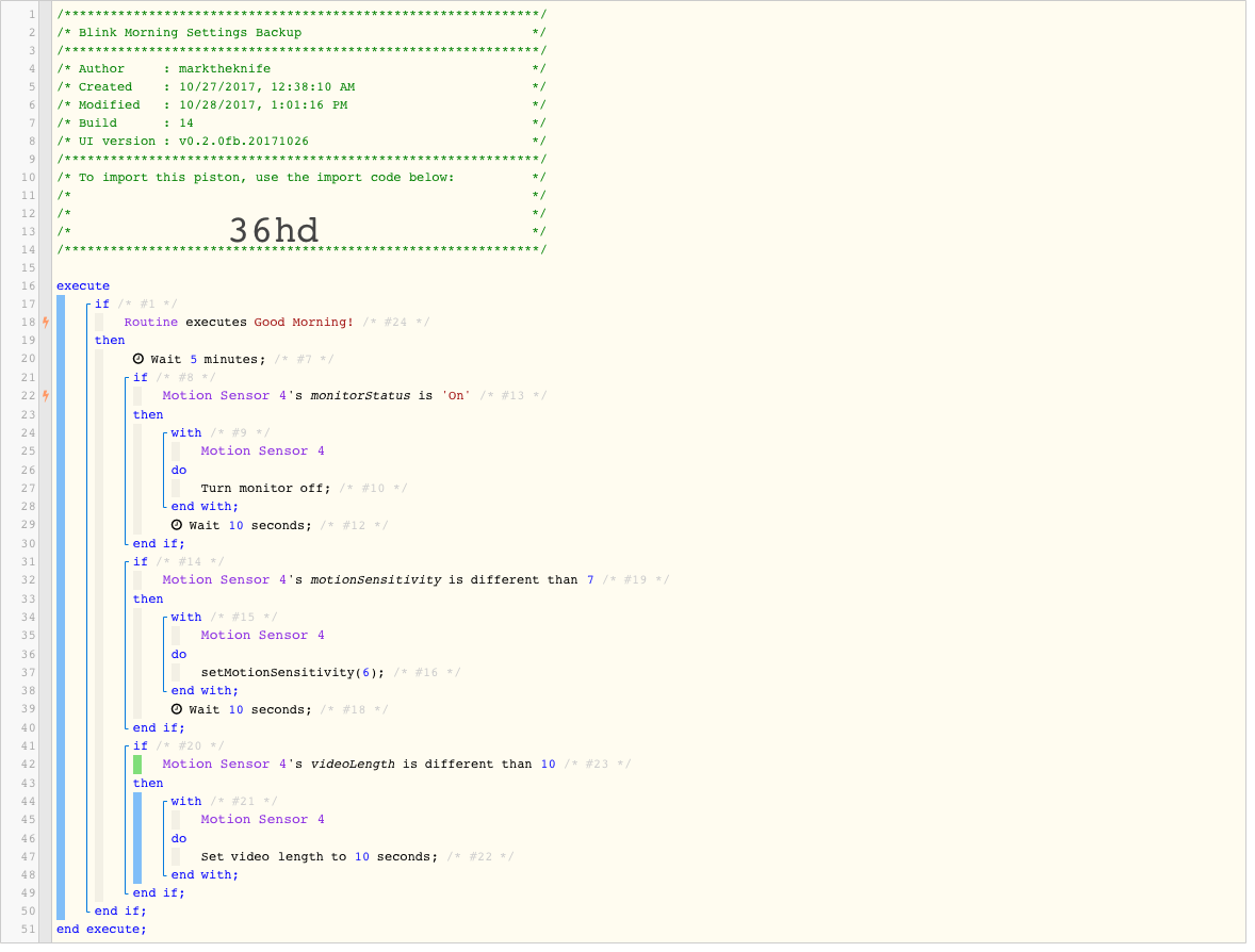

Here’s another try at it. I’m getting closer but still not quite there.

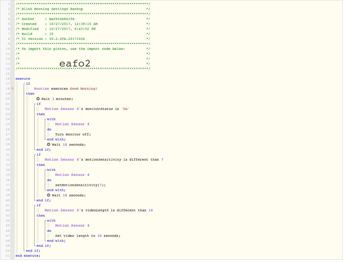

The piston starts when the routine executes, and then waits a minute.
But the piston never runs the if-then statement in 21-30. It could be I set the wrong condition, I’m not sure.
The other two actions that come next are running. But strangely, it’s setting the motion sensitivity to a value other than 7. It keeps changing to 9 in the Blink app. The setvideolength part works.
Do you have the logging set to full? Also turn the trace on. That will show visual bars next to conditions that were evaluated and whether they were true/false.
The motion sensitivity might just be getting the correct arguments passed to it.
Thanks, I need to run it again with fuller logging.
I checked with another piston that the state of the monitor on/off is the right condition to watch, and that I can turn it on/off too with a different trigger.
So it’s something about the logic in the first part. I’m probably trying to use the wrong comparator, and it’s never really checking for the status of the Blink monitor.
I’ll have to figure out what the right value is to send for motion sensitivity.

I ran the piston and it didn’t work that well. Here’s a screenshot with the trace. And the log below it.
10/28/2017, 1:27:42 PM +459ms
+1ms	╔Received event [******].time = 1509211663727 with a delay of -1269ms
+363ms	║RunTime Analysis CS > 218ms > PS > 114ms > PE > 31ms > CE
+374ms	║Runtime (39891 bytes) successfully initialized in 114ms (v0.2.0fb.20171026) (372ms)
+375ms	║╔Execution stage started
+422ms	║║Comparison (string) 3 is_different_than (integer) 10 = true (10ms)
+424ms	║║Condition #23 evaluated true (20ms)
+425ms	║║Condition group #20 evaluated true (state did not change) (21ms)
+427ms	║║Cancelling statement #21's schedules...
+3403ms	║║Executed physical command [*********].setVideoLength([10]) (2965ms)
+3404ms	║║Executed [*********].setVideoLength (2973ms)
+3408ms	║╚Execution stage complete. (3032ms)
+3415ms	╚Event processed successfully (3415ms)

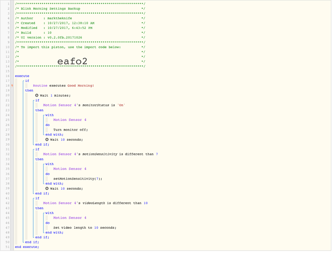

I figured out why the monitorstatus wasnt working. I input “On” when it should have been “on” without a capital O. Now that part works fine. And the set video length is good too.
So now it’s just that motionsensitivity, which is running but ends up with the wrong number in the blink app.
Good catch. Hopefully the motion sensitivity is simple. Test other values and see what it ends up as
Had to let it go for a few days as I was traveling.
But I just got it all sorted out.
I hadn’t noticed at first when creating a task there was a dropdown menu for adding different types of parameters.
I think it had defaulted to a string but when I tried adding an integer instead, it seems to work now.
Thanks for your suggestions!

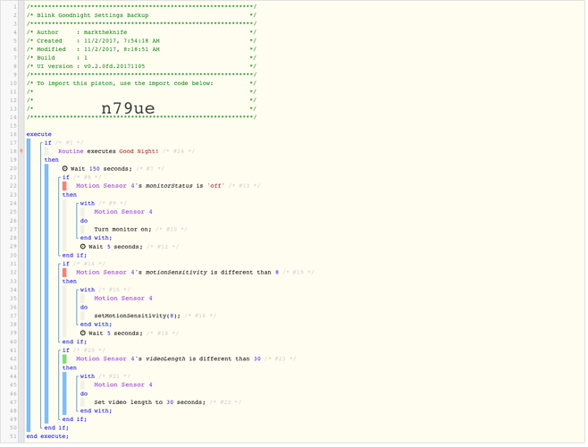

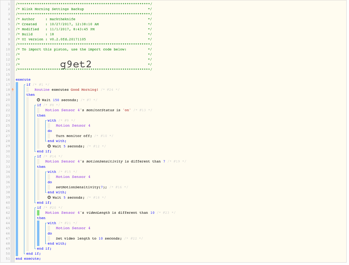

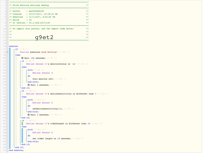

@marktheknife can you share the piston with us? Thanks
Sure here you go.

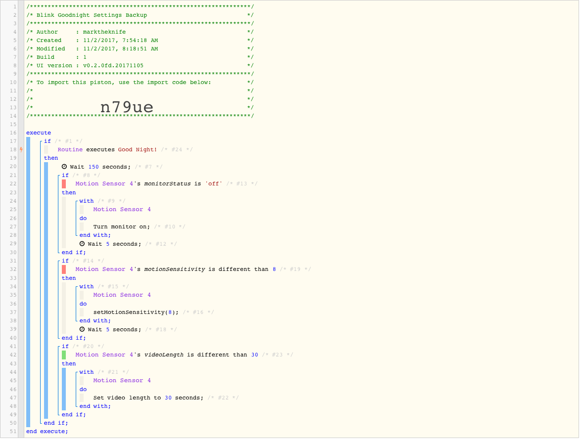

Once I got that one working, I made a similar piston to change the settings when my goodnight routine runs too.
