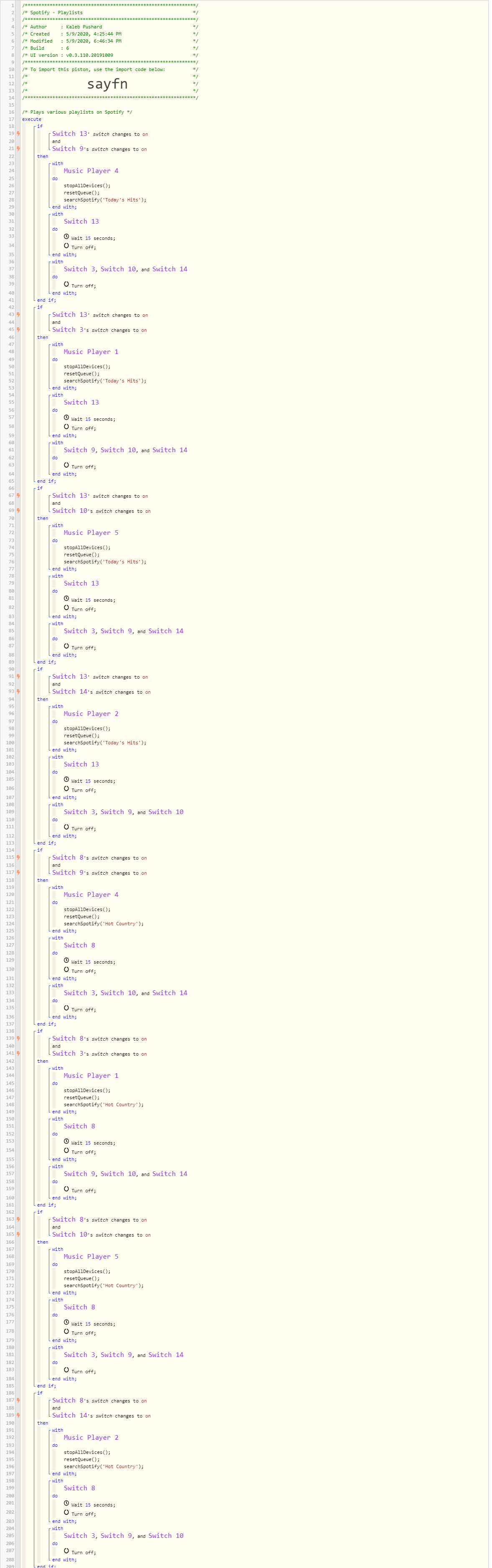

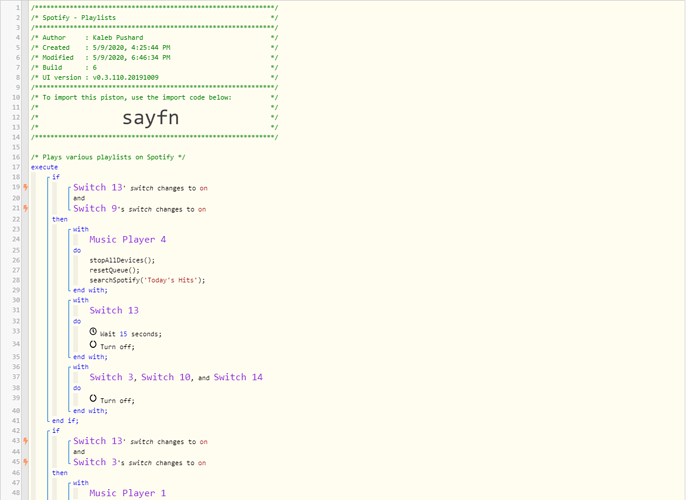

My Pistons don’t seem to be reacting when I try to trigger them in action tiles.
I created a trigger of “switch a” changed to on, and “switch b” switched to on, and it would execute a search and play of certain music on Spotify.
I am able to make one of them work, but I am unable to get the rest of them to work.
Basically, in action tiles, I have a list of rooms to play the music in (echo device in each, with echo speak enabled), and i have a list of genres/artists to play on Spotify.
I essentially want to “select the room” and “select the playlist” and have it play in the appropriate room.
It plays the Hot Country playlist, on first echo, but won’t play anywhere else.

In a nutshell, triggers are precise moments in time, so two of them cannot both be expected to fire at the same instant…
pic
The same logic applies to the rest of your code as well…
Perhaps you want to keep one of them as a trigger, and change one of them to a condition.
IE:
IF Switch 13 changes to on  <-- Trigger
   and
   Switch 9 IS on           <-- Condition
Thank you for that! I made the change and it’s working better! Now I’ve just got to figure out why it won’t play in some rooms. Thanks again!
I am glad we solved the reason for this thread…
Perhaps you can solution my post above as the ‘Solution’ to help others.
I would make a new topic on this, and only focus on a single block in a new piston.
Please could you put the final piston here? I was interested and would like to use it
I like where you are going with this. Thanks for the idea.
