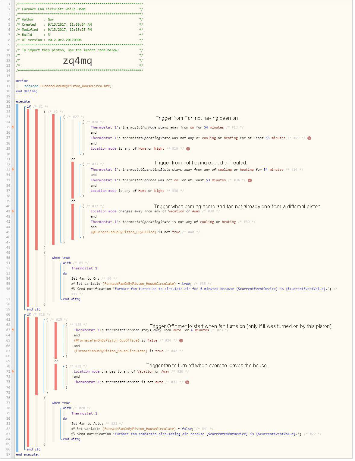

I am trying to create a rule that will turn on the furnace fan and circulate air for 5 minutes, if I’m home and the furnace has been idle for 60 minutes. What I’ve created here does nothing. Something tells me my triggers or conditions aren’t quite right. Can someone set me on the right path?
All the logs I have:
9/8/2017, 4:28:22 PM +519ms
+1ms ╔Starting piston… (v0.2.0e7.20170906)
+143ms ║╔Subscribing to devices…
+154ms ║║Subscribing to ecobee Thermostat.thermostatOperatingState…
+203ms ║╚Finished subscribing (62ms)
+233ms ║Comparison (string) :9f34787902a666d5a96a8b824ccc1c8b: is_any_of (string) :9f34787902a666d5a96a8b824ccc1c8b:,:3b318b1c0198e4edcc94624cf5fbf466: = true (2ms)
+257ms ║Comparison (enum) idle stays_away_from_any_of (string) cooling,fan only,heating = true (11ms)
+259ms ║Cancelling condition #8’s schedules…
+260ms ║Cancelling condition #2’s schedules…
+277ms ╚Piston successfully started (277ms)
