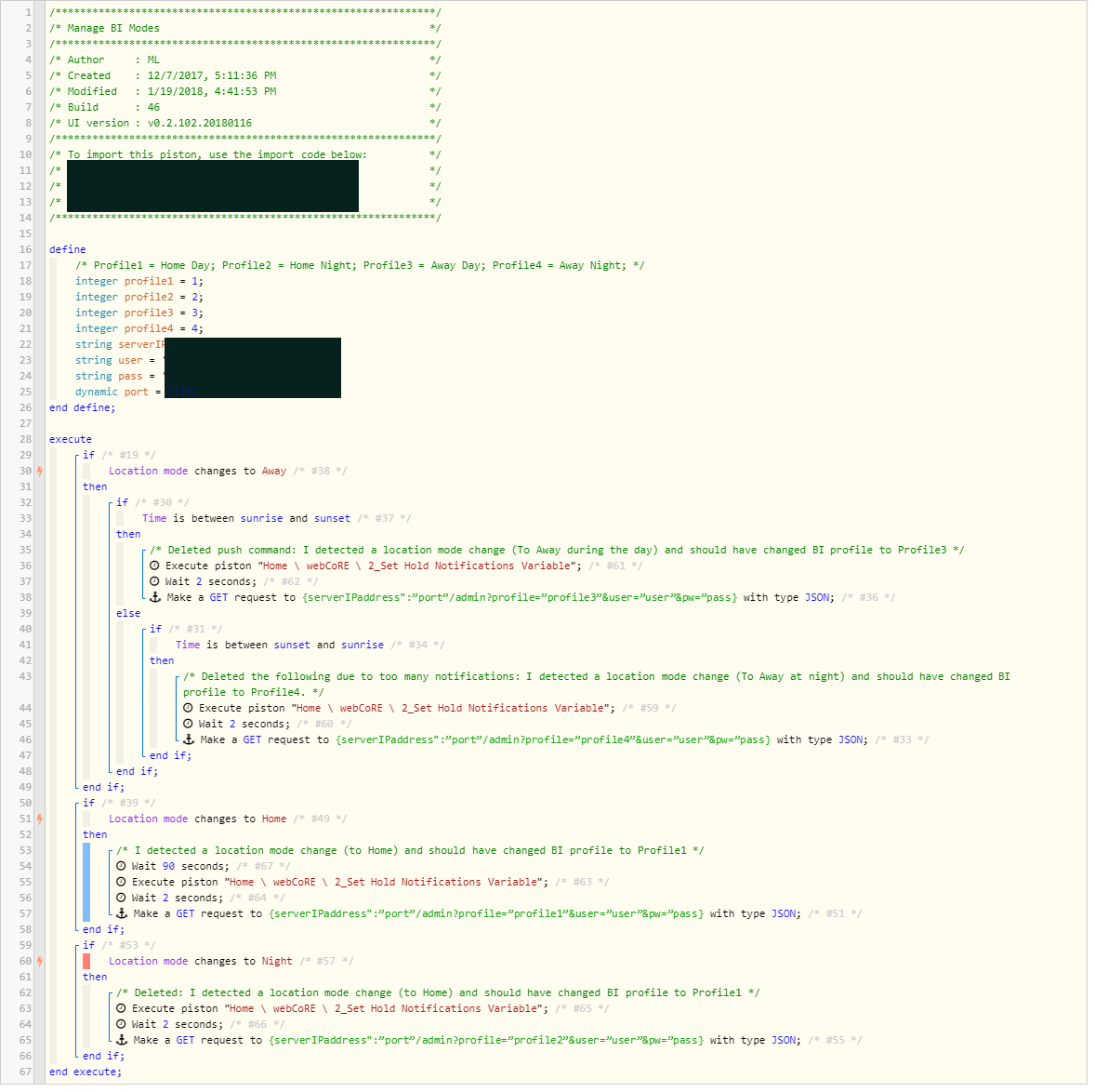

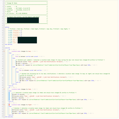

About a month ago I created a piston that changes the active profile in Blue Iris (BI) whenever a location mode change occurs. It was working perfectly until yesterday when I noticed that the profile didn’t change when I arrived home. I did some testing today and realize it no longer works. No recent changes were made to the piston or BI. If I format the command used to change the profile and execute it from a browser, it works. I’ve tried a number of things but cannot get this piston to work again. There is nothing in the log that indicates there is a problem. Or if there is, I’m not seeing it. I’m out of ideas as to how to troubleshoot this one.
A location changes intitiates a web request to BI to change the active profile.
This piston worked perfectly until yesterday. Now it issues the web request but Blue Iris does nothing. The same request issued from a browser works fine.
*5) Attach any logs (From ST IDE and by turning logging level to Full)
The logs below show a change from home to away and another change from away to home.
1/19/2018, 4:47:06 PM +372ms
+1ms ╔Received event [Home].time = 1516405627587 with a delay of -1215ms
+187ms ║RunTime Analysis CS > 34ms > PS > 58ms > PE > 94ms > CE
+190ms ║Runtime (52180 bytes) successfully initialized in 58ms (v0.2.102.20180116) (189ms)
+191ms ║╔Execution stage started
+233ms ║║Comparison (string) :fd6b2fd9366cdca291a786245b40fcf7: changes_to (string) :4f87089617dfb9cee9d4ec80da10baf8: = false (8ms)
+235ms ║║Condition #57 evaluated false (14ms)
+236ms ║║Condition group #53 evaluated false (state did not change) (15ms)
+238ms ║╚Execution stage complete. (48ms)
+239ms ╚Event processed successfully (239ms)
1/19/2018, 4:46:45 PM +333ms
+0ms ╔Received event [Home].time = 1516405606510 with a delay of -1178ms
+138ms ║RunTime Analysis CS > 16ms > PS > 40ms > PE > 82ms > CE
+141ms ║Runtime (52180 bytes) successfully initialized in 40ms (v0.2.102.20180116) (140ms)
+176ms ║║Executed virtual command executePiston (6ms)
+179ms ║║Executed virtual command wait (1ms)
+180ms ║║Waiting for 2000ms
+2216ms ║║Calculating (string) 192.168.1.164 + (string) : >> (string) 192.168.1.164:
+2221ms ║║Calculating (string) 192.168.1.164: + (string) 50081 >> (string) 192.168.1.nn:nnnnn
+2226ms ║║Calculating (string) 192.168.1.nn:nnnnn + (string) /admin?profile= >> (string) 192.168.1.nn:nnnnn/admin?profile=
+2230ms ║║Calculating (string) 192.168.1.nn:nnnnn/admin?profile= + (string) 1 >> (string) 192.168.1.nn:nnnnn/admin?profile=1
+2234ms ║║Calculating (string) 192.168.1.nn:nnnnn/admin?profile=1 + (string) &user= >> (string) 192.168.1.nn:nnnnn/admin?profile=1&user=
+2237ms ║║Calculating (string) 192.168.1.nn:nnnnn/admin?profile=1&user= + (string) UserID >> (string) 192.168.1.nn:nnnnn/admin?profile=1&user=UserID
+2240ms ║║Calculating (string) 192.168.1.nn:nnnnn/admin?profile=1&user=UserID + (string) &pw= >> (string) 192.168.1.nn:nnnnn/admin?profile=1&user=UserID&pw=
+2243ms ║║Calculating (string) 192.168.1.nn:nnnnn/admin?profile=1&user=UserID&pw= + (string) Password >> (string) 192.168.1.nn:nnnnn/admin?profile=1&user=UserID&pw=Password
+2250ms ║║Sending internal web request to: 192.168.1.nn:nnnnn/admin?profile=1&user=UserID&pw=Password
+2252ms ║║Executed virtual command httpRequest (3ms)
+2253ms ║║Requesting a wake up for Fri, Jan 19 2018 @ 4:47:07 PM MST (in 20.0s)
+2258ms ║╚Execution stage complete. (2115ms)
+2259ms ║Setting up scheduled job for Fri, Jan 19 2018 @ 4:47:07 PM MST (in 19.995s)
+2301ms ╚Event processed successfully (2302ms)
1/19/2018, 4:45:16 PM +245ms
+0ms ╔Received event [Home].mode = Home with a delay of 131ms
+215ms ║RunTime Analysis CS > 35ms > PS > 60ms > PE > 120ms > CE
+219ms ║Runtime (52173 bytes) successfully initialized in 60ms (v0.2.102.20180116) (218ms)
+221ms ║╔Execution stage started
+234ms ║║Comparison (string) :fd6b2fd9366cdca291a786245b40fcf7: changes_to (string) :9984339f75f446f9c06978e611709967: = false (0ms)
+236ms ║║Cancelling condition #38’s schedules…
+237ms ║║Condition #38 evaluated false (8ms)
+239ms ║║Cancelling condition #19’s schedules…
+240ms ║║Condition group #19 evaluated false (state changed) (11ms)
+248ms ║║Comparison (string) :fd6b2fd9366cdca291a786245b40fcf7: changes_to (string) :fd6b2fd9366cdca291a786245b40fcf7: = true (1ms)
+250ms ║║Cancelling condition #49’s schedules…
+252ms ║║Condition #49 evaluated true (7ms)
+253ms ║║Cancelling condition #39’s schedules…
+254ms ║║Condition group #39 evaluated true (state changed) (10ms)
+258ms ║║Cancelling statement #50’s schedules…
+263ms ║║Executed virtual command wait (0ms)
+264ms ║║Requesting a wake up for Fri, Jan 19 2018 @ 4:46:46 PM MST (in 90.0s)
+271ms ║╚Execution stage complete. (51ms)
+273ms ║Setting up scheduled job for Fri, Jan 19 2018 @ 4:46:46 PM MST (in 89.993s)
+440ms ╚Event processed successfully (440ms)
1/19/2018, 4:44:19 PM +324ms
+1ms ╔Received event [Home].time = 1516405460785 with a delay of -1461ms
+173ms ║RunTime Analysis CS > 21ms > PS > 58ms > PE > 89ms > CE
+176ms ║Runtime (52180 bytes) successfully initialized in 58ms (v0.2.102.20180116) (175ms)
+177ms ║╔Execution stage started
+201ms ║║Comparison (string) :9984339f75f446f9c06978e611709967: changes_to (string) :fd6b2fd9366cdca291a786245b40fcf7: = false (4ms)
+203ms ║║Condition #49 evaluated false (8ms)
+204ms ║║Condition group #39 evaluated false (state did not change) (9ms)
+210ms ║║Comparison (string) :9984339f75f446f9c06978e611709967: changes_to (string) :4f87089617dfb9cee9d4ec80da10baf8: = false (1ms)
+212ms ║║Condition #57 evaluated false (4ms)
+213ms ║║Condition group #53 evaluated false (state did not change) (5ms)
+215ms ║╚Execution stage complete. (38ms)
+216ms ╚Event processed successfully (216ms)
1/19/2018, 4:43:58 PM +474ms
+0ms ╔Received event [Home].mode = Away with a delay of 130ms
+167ms ║RunTime Analysis CS > 33ms > PS > 53ms > PE > 82ms > CE
+171ms ║Runtime (52173 bytes) successfully initialized in 53ms (v0.2.102.20180116) (169ms)
+181ms ║║Comparison (string) :9984339f75f446f9c06978e611709967: changes_to (string) :9984339f75f446f9c06978e611709967: = true (0ms)
+183ms ║║Cancelling condition #38’s schedules…
+184ms ║║Condition #38 evaluated true (6ms)
+185ms ║║Cancelling condition #19’s schedules…
+186ms ║║Condition group #19 evaluated true (state changed) (8ms)
+228ms ║║Comparison (time) 60238663 is_between (time) 1516371420000 … (time) 1516406640000 = true (10ms)
+229ms ║║Time restriction check passed
+231ms ║║Condition #37 evaluated true (43ms)
+232ms ║║Condition group #30 evaluated true (state did not change) (44ms)
+234ms ║║Cancelling statement #35’s schedules…
+247ms ║║Executed virtual command executePiston (7ms)
+251ms ║║Executed virtual command wait (1ms)
+252ms ║║Waiting for 2000ms
+2274ms ║║Calculating (string) 192.168.1.164 + (string) : >> (string) 192.168.1.164:
+2278ms ║║Calculating (string) 192.168.1.164: + (string) 50081 >> (string) 192.168.1.nn:nnnnn
+2282ms ║║Calculating (string) 192.168.1.nn:nnnnn + (string) /admin?profile= >> (string) 192.168.1.nn:nnnnn/admin?profile=
+2286ms ║║Calculating (string) 192.168.1.nn:nnnnn/admin?profile= + (string) 3 >> (string) 192.168.1.nn:nnnnn/admin?profile=3
+2291ms ║║Calculating (string) 192.168.1.nn:nnnnn/admin?profile=3 + (string) &user= >> (string) 192.168.1.nn:nnnnn/admin?profile=3&user=
+2294ms ║║Calculating (string) 192.168.1.nn:nnnnn/admin?profile=3&user= + (string) UserID >> (string) 192.168.1.nn:nnnnn/admin?profile=3&user=UserID
+2297ms ║║Calculating (string) 192.168.1.nn:nnnnn/admin?profile=3&user=UserID + (string) &pw= >> (string) 192.168.1.nn:nnnnn/admin?profile=3&user=UserID&pw=
+2300ms ║║Calculating (string) 192.168.1.nn:nnnnn/admin?profile=3&user=UserID&pw= + (string) Password >> (string) 192.168.1.nn:nnnnn/admin?profile=3&user=UserID&pw=Password
+2307ms ║║Sending internal web request to: 192.168.1.nn:nnnnn/admin?profile=3&user=UserID&pw=Password
+2309ms ║║Executed virtual command httpRequest (3ms)
+2310ms ║║Requesting a wake up for Fri, Jan 19 2018 @ 4:44:20 PM MST (in 20.0s)
+2316ms ║╚Execution stage complete. (2145ms)
+2318ms ║Setting up scheduled job for Fri, Jan 19 2018 @ 4:44:20 PM MST (in 19.994s)
+2329ms ╚Event processed successfully (2329ms)
