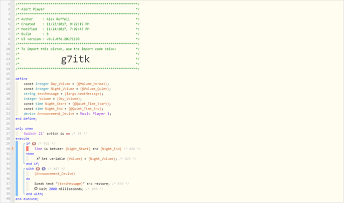

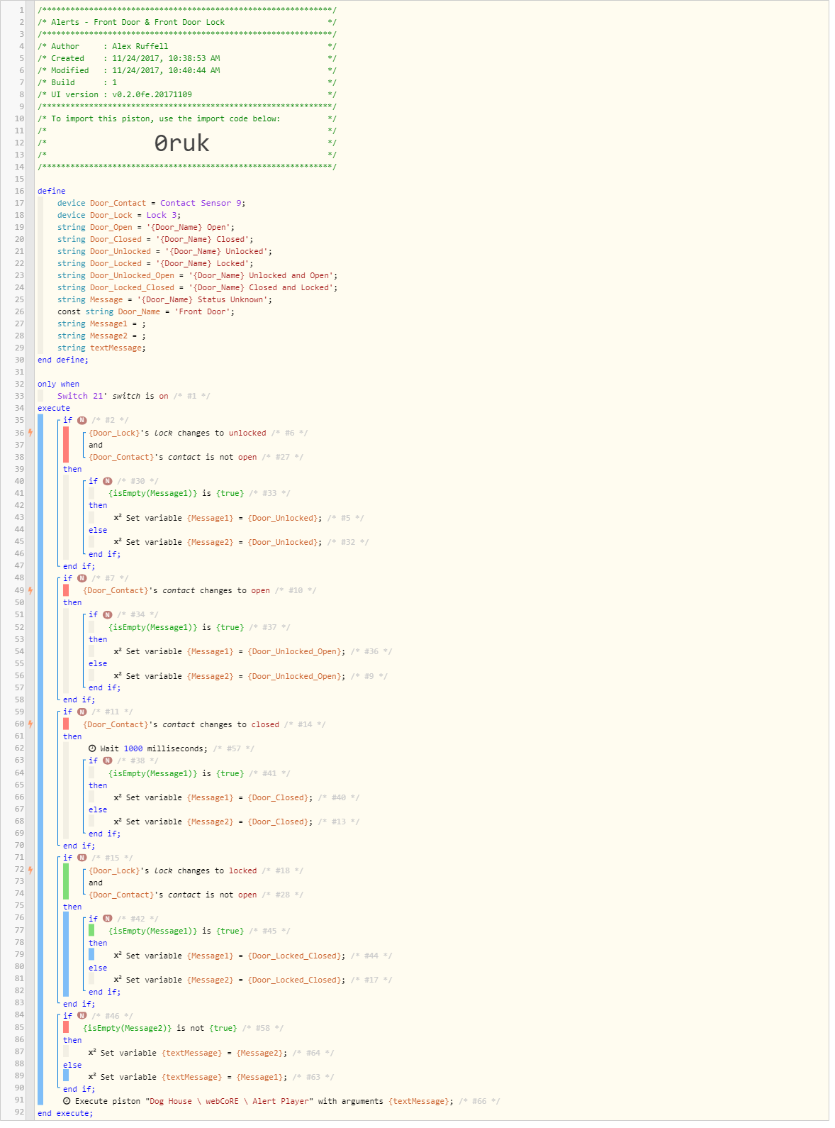

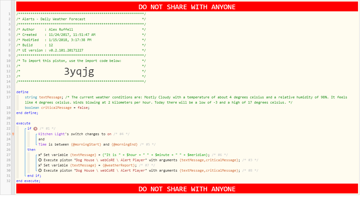

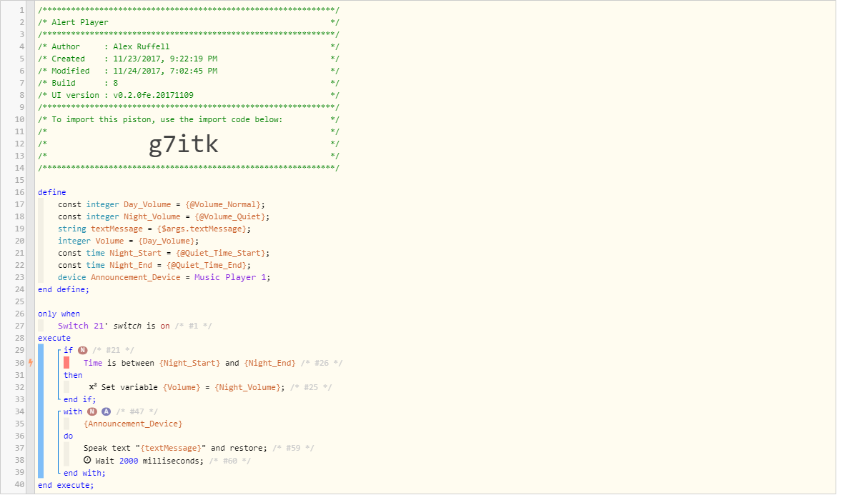

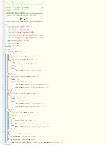

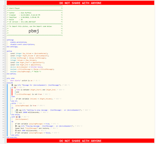

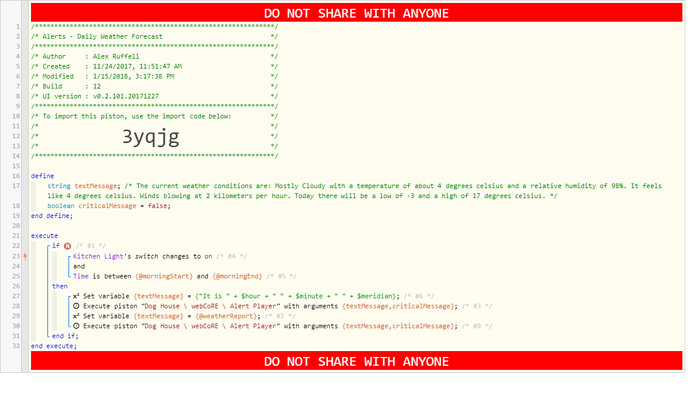

A growing number of my pistons included code to play messages on my Kitchen Sonos. This led to duplicated and inconsistent code. To address this issue and make all other pistons lighter/simpler, I created a piston that plays a string sent to it via an attribute. The code is quite simple as it just looks at what time it is to set the appropriate volume and then plays the message. I am planning on adding an override Boolean to enable a loud message during quiet times for cases where it is a critical message.
I’d like my piston to play the text in the textMessage attribute completely before moving on to the next message. The 2000ms wait was just an attempt to give the piston enough time to play a typical message but it doesn’t seem to make any difference.
I can’t figure out how to prevent overlapping messages from interfering with each other. Messages get truncated by each other mostly, or some just get skipped. I am wondering whether a small buffer might help to keep messages in queue but if I am not mistaken, each time the Piston is run, the variables get reset so I am not sure how to accomplish this.
The logs below are what is in the log. It may or may not include the issue. I’ll have to force the overlapping to get a log of that if necessary.

+199ms ║║Comparison (time) 71768889 is_between (time) 77400000 … (time) 23400000 = false (8ms)
+200ms â•‘â•‘Condition #26 evaluated false (15ms)
+201ms ║║Cancelling statement #26’s schedules…
+210ms â•‘â•‘Requesting time schedule wake up at Fri, Nov 24 2017 @ 9:30:00 PM CST
+213ms â•‘â•‘Condition group #21 evaluated false (state did not change) (27ms)
+1137ms â•‘â•‘Executed physical command [Kitchen Sonos].playTextAndRestore([T Rex escaped containment zone, 60]) (912ms)
+1138ms â•‘â•‘Executed [Kitchen Sonos].playTextAndRestore (913ms)
+1142ms â•‘â•‘Executed virtual command [Kitchen Sonos].wait (0ms)
+1142ms â•‘â•‘Waiting for 2000ms
+3146ms ║╚Execution stage complete. (2979ms)
+3148ms â•‘Setting up scheduled job for Fri, Nov 24 2017 @ 9:30:00 PM CST (in 5628.15s)
+3204ms ╚Event processed successfully (3204ms)
11/24/2017, 7:05:02 PM +795ms
+0ms â•”Received event [Dog House].execute = :609aeefd68292337bb328175d3086833: with a delay of 7ms
+171ms â•‘RunTime Analysis CS > 26ms > PS > 98ms > PE > 47ms > CE
+182ms â•‘Runtime (40692 bytes) successfully initialized in 98ms (v0.2.0fe.20171109) (181ms)
+183ms â•‘â•”Execution stage started
+196ms â•‘â•‘Comparison (enum) on is (string) on = true (2ms)
+198ms â•‘â•‘Condition #1 evaluated true (9ms)
+198ms â•‘â•‘Condition group #null evaluated true (state did not change) (10ms)
+214ms ║║Comparison (time) 68702996 is_between (time) 77400000 … (time) 23400000 = false (8ms)
+216ms â•‘â•‘Condition #26 evaluated false (15ms)
+217ms ║║Cancelling statement #26’s schedules…
+225ms â•‘â•‘Requesting time schedule wake up at Fri, Nov 24 2017 @ 9:30:00 PM CST
+228ms â•‘â•‘Condition group #21 evaluated false (state did not change) (27ms)
+373ms â•‘â•‘Executed physical command [Kitchen Sonos].playTextAndRestore([Garage Door Closed and Locked, 60]) (132ms)
+374ms â•‘â•‘Executed [Kitchen Sonos].playTextAndRestore (133ms)
+377ms â•‘â•‘Executed virtual command [Kitchen Sonos].wait (0ms)
+378ms â•‘â•‘Waiting for 2000ms
+2382ms ║╚Execution stage complete. (2199ms)
+2384ms â•‘Setting up scheduled job for Fri, Nov 24 2017 @ 9:30:00 PM CST (in 8694.822s)
+2403ms ╚Event processed successfully (2402ms)
