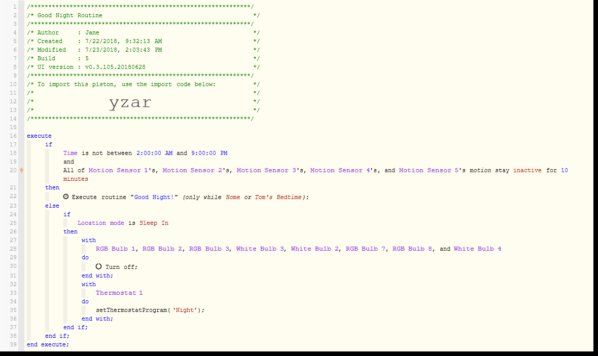

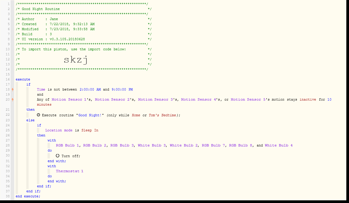

OK, this is what I have so far. I can’t figure out how to set my Ecobee to “Night” mode though.
I can’t help with the Ecobee, but make sure you change that “Any of… motion sensors” to "All of… motion sensors. Otherwise as long as one sensor doesn’t trip, you’ll end up sitting in the dark. :slight_smile:
Wouldn’t be the first time! :smirk: Thanks I changed that Any to All. Now to get the Ecobee working.
This is what I have now. I will let you know if it works tonight.
