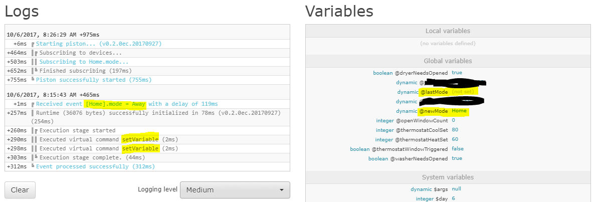

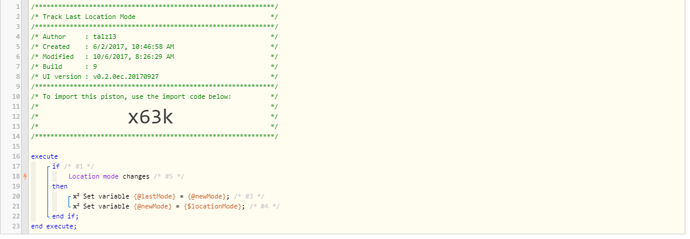

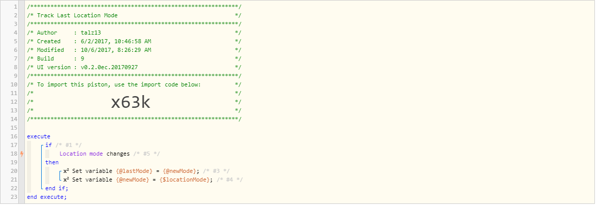

I have a piston that updates 2 global variables when the Location Mode changes, but it is not updating the variables
I expect ‘@lastMode’ to be updated with the previous mode, and ‘@newMode’ to be updated with the new mode change.
One or both of the variables do not appear to be updating.
Try changing the global variable types to string.
Run the piston again, maybe @newMode was not set and that was inherited into @lastMode? You need at least two runs for @lastMode to have valid data.
The problem had been that @lastMode never appeared to update, like Good Morning routine would run, which should result in @lastMode = Night, @newMode = Home, but @lastMode would still be Away from arriving home at some point.

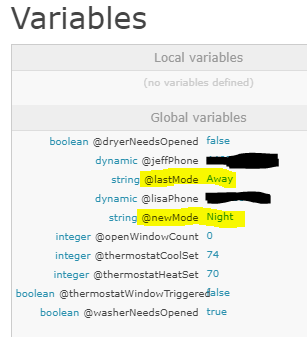

Current state is:
@lastMode = (not set)
@newMode = Away
I let it run a few more times, and currently, after we returned from being away, the variable states are:
@lastMode = Away
@newMode = Night
the state should be:
@lastMode = Away
@newMode = Home

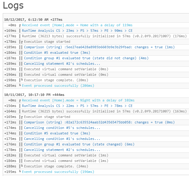

I also bumped up logging to Full, and here’s what it’s showing now:

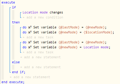

I was going to try re-setting this up today, and noticed something… I’m setting @newMode to the variable $locationMode, not the state of the virtual device Location Mode.
Here’s a screenshot of the two setups next to each other:
I’m going to try making this change (to the 2nd way), and see if it helps resolve the issue.

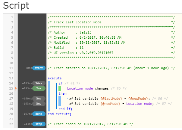

Looks like it’s still not updating correctly after my last change:
