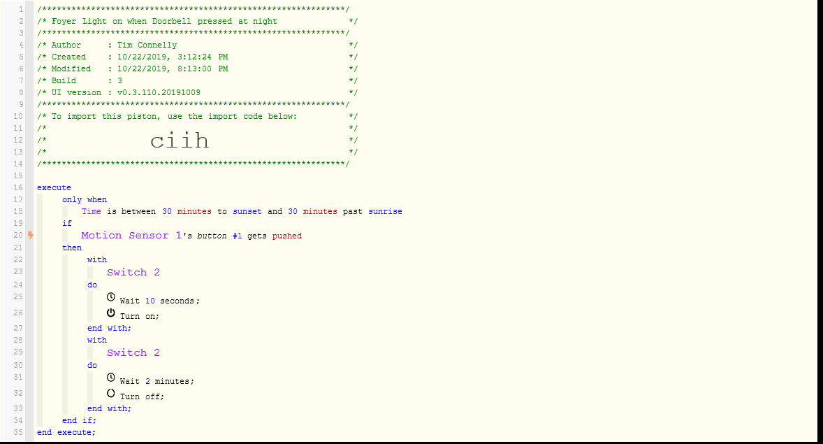

I have attempted to create a piston to turn on a light 10 seconds after my Ring Doorbell is pressed when it is between sunset and sunrise and then turn it off 2 mins later. A copy of the piston is shown below.
The light should come on 10 seconds after the doorbeel is pressed (assuming that it is between 30 mins before Sunset and 30 mins after sunrise). The light should stay on for 2 mins and then shut off.
Everything happens correctly, except the light does not shut off. I have moved the wait and off statements around trying to get them to function correctly with no success.
