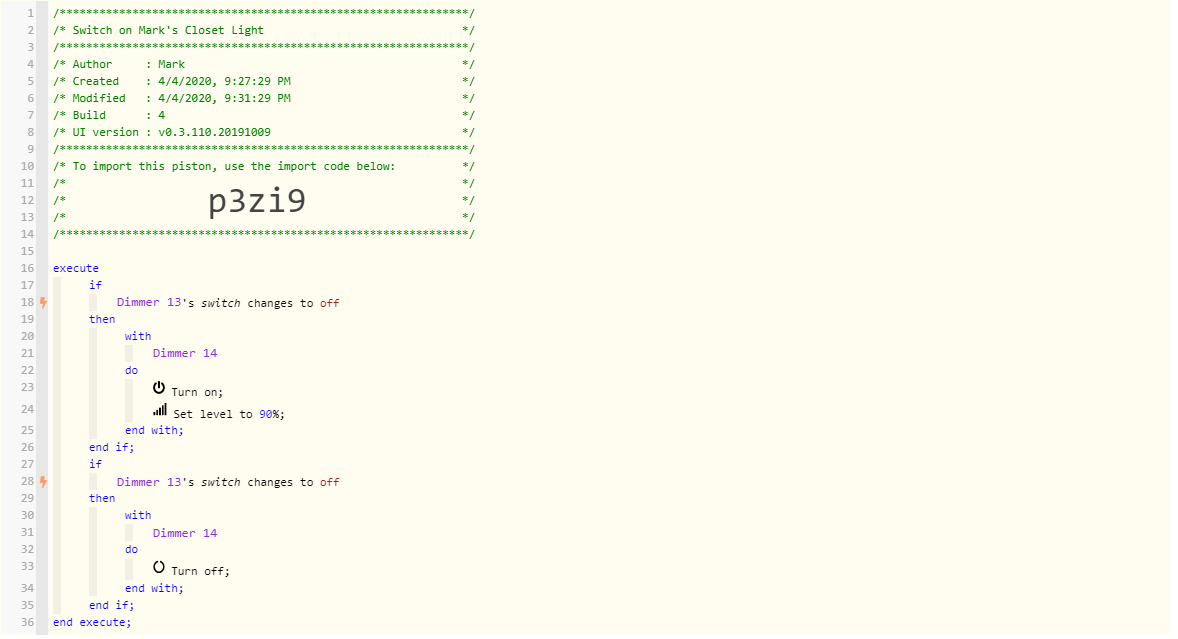

Piston to turn on smart bulb with switch
Trying to create a simple piston that turn on a zigbee smart bulb when a Zwave light switch is turned on.
Smat bulb turns on and off with physical switch
Bulb isnt responding

I believe in the first IF block you want the dimmer switch changes to ON not OFF in order to turn the bulb on? otherwise in your piston above, you have both triggers changing to OFF for the dimmer switch
LOl it was set to on, Ive been playing with it. Its not working for on or off.
if both are off it will be conflicted…
is it ON or OFF?
plus, what changes the dimmer OFF??
if the dimmer goes down to 3% - let’s say - it’s not OFF. The lights might be off but the dimmer is not.
setting both to off was a mistake, thats not the issue. If i tap the dimmer once its turns its lights off but the closet bulb stays on. Same goes for turning the dimmer switch on. The bathroom lights come on but the closet bulb doesnt

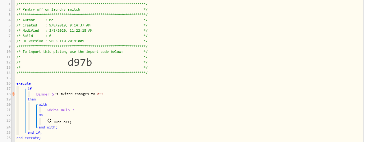

The bottom half of your piston is exactly the same as one I use that turns off the smart bulb in the pantry when you turn off the dimmer switch in the laundry room. They are turned on with motion sensors and those are separate pistons, but the turn off is exactly the same. So I don’t see why that would not work. You can control the smart bulb with the app right?
My smart bulb is dimmable but it is not shown as a dimmer.
Yes I can turn it off with the app. Its a Cree connected light bulb using zigbee.
