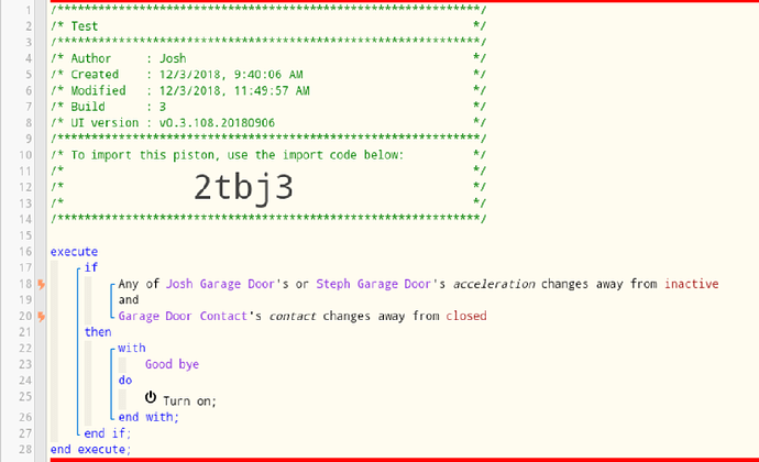

I’m trying to figure out a better way to set the away/home mode. My wife’s presence sensor of her phone doesn’t seem to work for more than about a day, and while mine is more reliable, it’s not the best.
What I want to happen is for if the Garage door changes to active, then the contact sensor changes to open (or away from closed) I want the virtual switch to turn on.
The switch is not being triggered. I think the issue is I want the garage door acceleration to change first, then the contact sensor change to open. Not sure how to make that happen in the right sequence.
