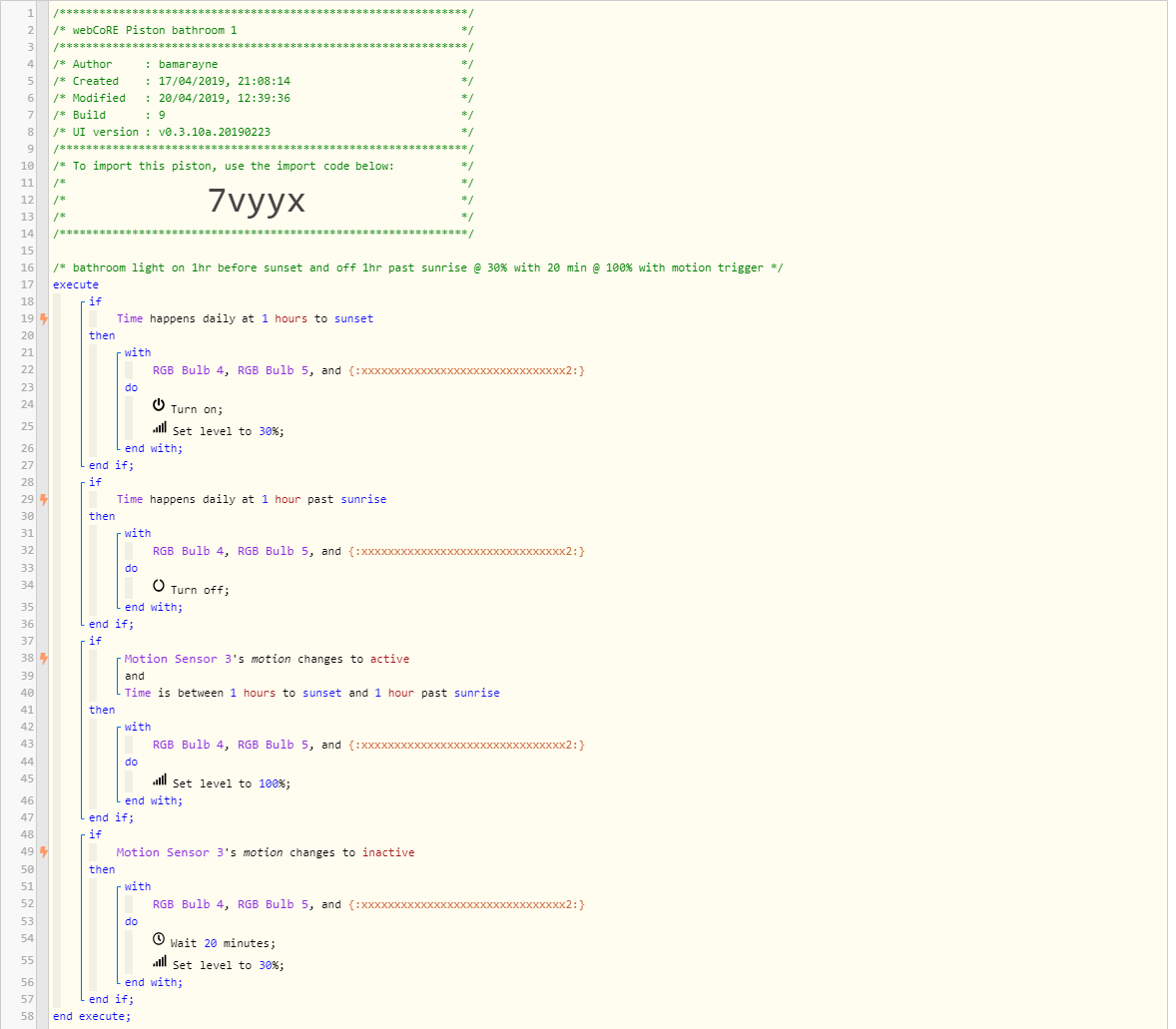

i have 2 hue bulbs set in the bathroom to turn on at 30% 1hr before sunset and turn off 1hr past sunrise i also have a motion sensor that when triggered the light level to 100% for 20 mins this all works perfect in theses times but for some reason i am getting the lights going on at 30% outside of theses time and i think it relates to the motion sensor triggering it but not every time
this is the first piston i have done so not sure its 100% correct but seems fine to me due to it working at the set times
