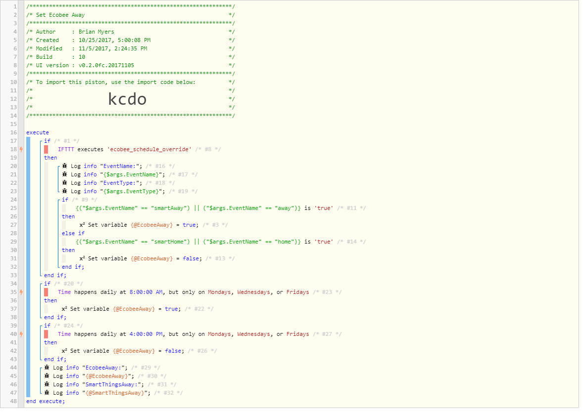

I have a piston design to trigger at a time of day. Since daylight savings ended last night, it is triggering an hour early but I’m not sure why.
The piston would trigger at 4pm and then show that it is scheduled to run at 8am.
The piston just triggered at 3pm and it is showing that is scheduled to run next at 7am.
I there wasn’t anything in the SmartThings IDE logs from 3pm, but here’s the logs from webCoRE

It is a known issue and I am looking into it. Please bear with me, there is nothing wrong with the piston itself, this is most likely a webCoRE bug at this time. Thank you
