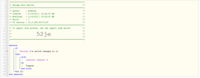

Here is the simpliest one I have. I actually seems to be working this morning. Its what I used to open my garage door. I have this set up to a routine so that I can easily open and close the garage door from a widget on my iPhone.
The switch is a momentary switch. Contact sensor is the garage door. Like I said this one seems to be working at this moment, but it still has consistent “Piston waited at a semaphore”, usually for 275-900ms.
