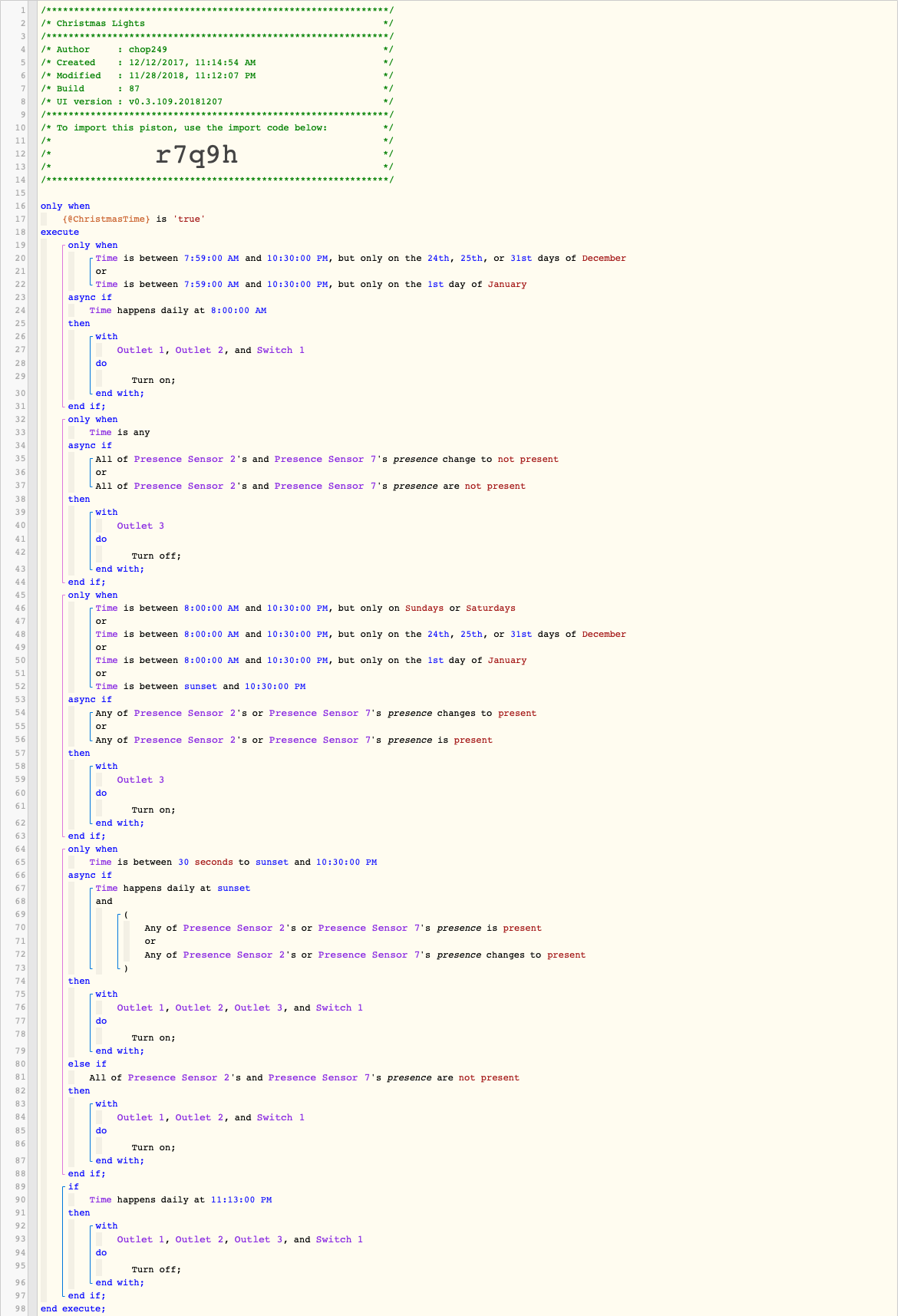

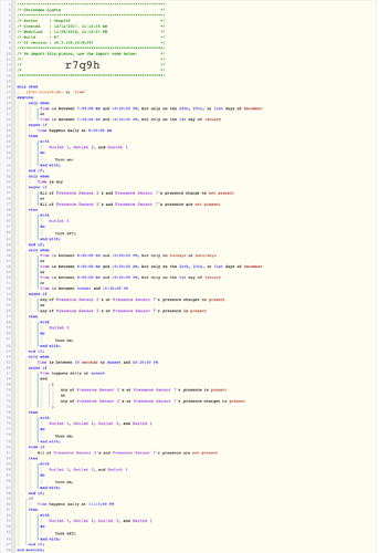

The piston was operating correctly turning Christmas lights on at sunset but now is not for the last few days. I’m not sure where it is hiccuping. I don’t understand the correlation between the Log Lines noted and the code lines.
Turn on all Christmas lights including the tree if the wife or I am home at sunset. If neither of us is home then turn on everything except the firestarter (aka Christmas tree).
Shutdown at 11:13PM seems to work. Last year the turning on and off of the tree worked upon departure and arrival. Up until the last ST update everything seemed to come on at sunset as it should have. The only exception being the tree because we didn’t get it up till Monday night I believe.
12/18/2018, 5:25:59 PM +141ms
+1ms ╔Received event [Home].time = 1545175560000 with a delay of -860ms
+182ms ║RunTime Analysis CS > 45ms > PS > 52ms > PE > 85ms > CE
+186ms ║Runtime (51911 bytes) successfully initialized in 52ms (v0.3.109.20181207) (183ms)
+188ms ║╔Execution stage started
+206ms ║║Comparison (dynamic) true is (boolean) true = true (3ms)
+209ms ║║Condition #55 evaluated true (12ms)
+211ms ║║Condition group #null evaluated true (state did not change) (15ms)
+234ms ║║Comparison (time) 62759357 is_between (time) 28740000 … (time) 81000000 = true (15ms)
+266ms ║║Time restriction check failed
+269ms ║║Condition #88 evaluated false (53ms)
+287ms ║║Comparison (time) 62759412 is_between (time) 28740000 … (time) 81000000 = true (13ms)
+311ms ║║Time restriction check failed
+314ms ║║Condition #89 evaluated false (43ms)
+315ms ║║Condition group #83 evaluated false (state did not change) (101ms)
+324ms ║║Comparison (time) 62759462 is_any = true (1ms)
+326ms ║║Time restriction check passed
+328ms ║║Condition #91 evaluated true (8ms)
+330ms ║║Cancelling condition #70’s schedules…
+332ms ║║Condition group #70 evaluated true (state changed) (12ms)
+346ms ║║Condition #73 evaluated false (12ms)
+366ms ║║Comparison (enum) present is (string) not present = false (2ms)
+368ms ║║Condition #90 evaluated false (21ms)
+370ms ║║Cancelling condition #70’s schedules…
+372ms ║║Condition group #70 evaluated false (state changed) (38ms)
+391ms ║║Comparison (time) 62759517 is_between (time) 28800000 … (time) 81000000 = true (12ms)
+393ms ║║Time restriction check failed
+395ms ║║Condition #77 evaluated false (20ms)
+412ms ║║Comparison (time) 62759538 is_between (time) 28800000 … (time) 81000000 = true (11ms)
+414ms ║║Time restriction check failed
+416ms ║║Condition #78 evaluated false (19ms)
+432ms ║║Comparison (time) 62759558 is_between (time) 28800000 … (time) 81000000 = true (12ms)
+434ms ║║Time restriction check failed
+437ms ║║Condition #79 evaluated false (19ms)
+505ms ║║Comparison (time) 62759579 is_between (time) 1545175620000 … (time) 81000000 = false (14ms)
+507ms ║║Condition #80 evaluated false (69ms)
+509ms ║║Condition group #66 evaluated false (state did not change) (133ms)
+530ms ║║Comparison (time) 62759654 is_between (time) 1545175620000 … (time) 81000000 = false (13ms)
+532ms ║║Condition #100 evaluated false (20ms)
+533ms ║║Condition group #57 evaluated false (state did not change) (21ms)
+540ms ║║Comparison (time) 62759678 happens_daily_at (time) 83580000 = false (1ms)
+542ms ║║Condition #102 evaluated false (5ms)
+543ms ║║Cancelling statement #102’s schedules…
+548ms ║║Requesting time schedule wake up at Tue, Dec 18 2018 @ 11:13:00 PM CST
+551ms ║║Condition group #101 evaluated false (state did not change) (14ms)
+554ms ║╚Execution stage complete. (367ms)
+556ms ║Setting up scheduled job for Tue, Dec 18 2018 @ 11:13:00 PM CST (in 20820.304s)
+565ms ╚Event processed successfully (565ms)
