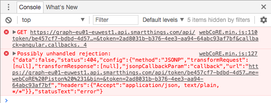

While loading main page (dashboard.webcore.co) : no errors (but no pistons)
While trying to create a new piston :
Ok, that’s an error in the IDE then - can you please open the IDE and fish for errors in the live logging?
Ok, I get this with the tag “error” : 08:52:47: error physicalgraph.exception.NotFoundException: Cound not find a SmartApp with the name webCoRE Piston in namespace ady624 @ line 967…
