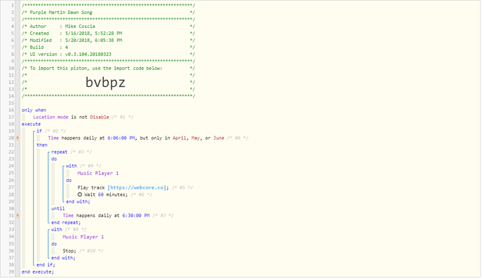

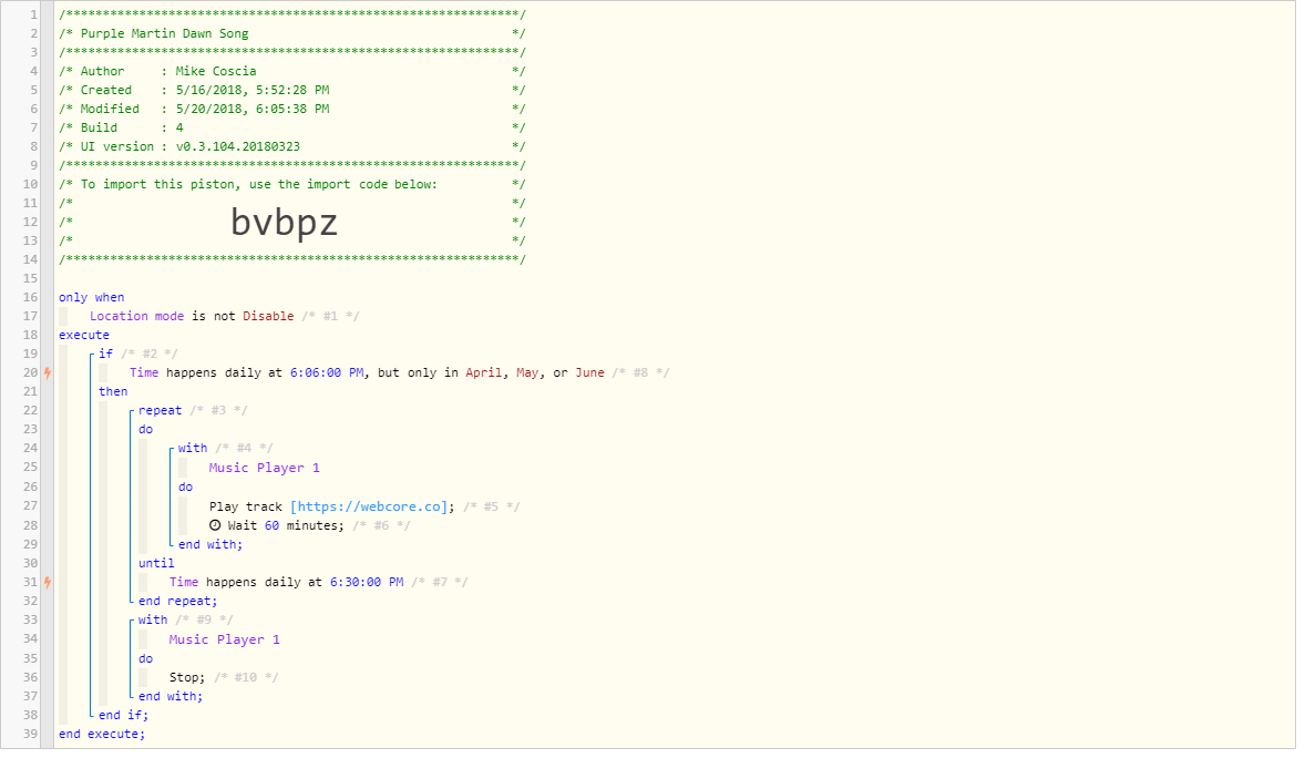

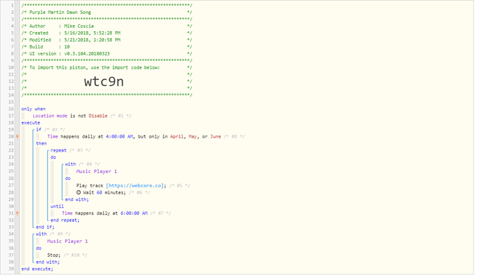

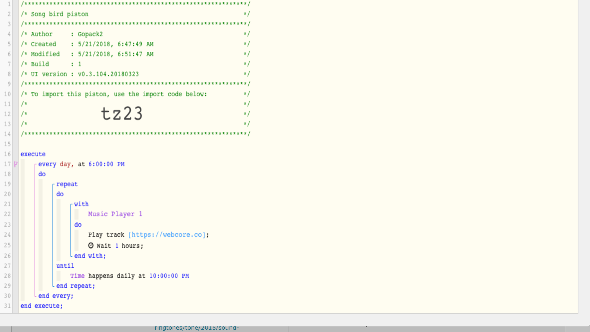

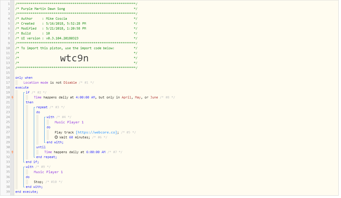

I want to play a specific music track at a specific time and end at a specific time every day. Attempting to lure song birds (purple martin) to a new nest colony I set up in the yard with their mating song.
At 4am every morning during April, May and June the track Purple Martin Dawn song will play until approx 12pm. The track is only about an hour long, so I want it too loop until 12pm, then stop. Then repeat the next day. I uploaded the track to my Google Music Library and pasted the link into webcore.
The song is not playing unless I started it manually in the sonos app. If I use my Sonos for something else, the song no longer plays when the piston calls for it. I am also seeing a play track every 60min in SmartThings outside the time frame that I set.
