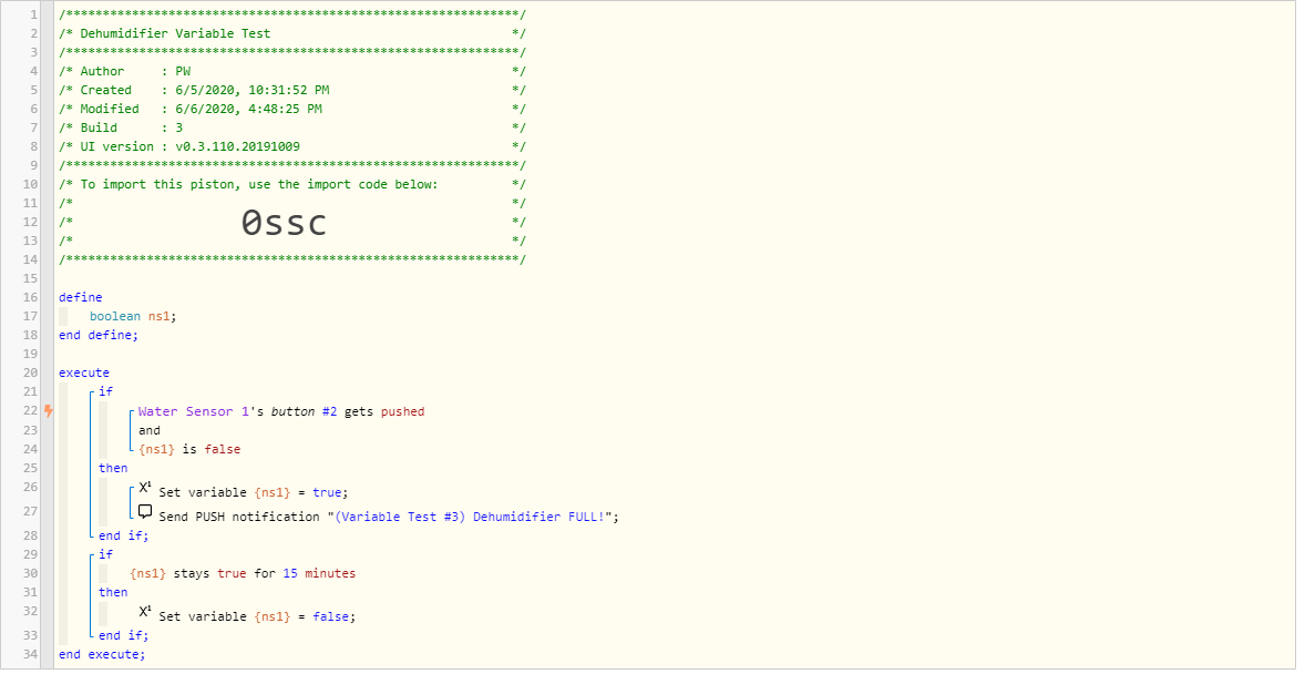

I just set it to what I think you are saying, shown below. I pulled the bucket to simulate blinking, and actually set it to 15 minutes instead of 5. Thinking this is the way we’d likely use it, and see how it goes. Well, I pulled it at 4:30, but at 4:45 I didn’t see any alerts… and even waited a few extra minutes. No notifications. I realize I set it to the wrong type of notifications! UGH. Testing again. Anyway, please take a look at the code to ensure it matches what your suggestion is before I continue. Thanks again.

@vPeteWalker that’s correct. 2 things, make sure the variable is set to false initially, or it won’t run. Either manually set it to false.
Or the first time you run the piston change it to
If variable IS NOT false.
then it will run.
then go back and edit it back to IS false
and for testing purposes.
ALWAYS use If variable stays true for 1 minute
then set variable to false.
You’ll see it work quicker, then after set it to 15 minutes.
Another pro tip, my you’re really getting your moneys worth here, is Log to console.
Under your push notification, add Log to console “Variable set to true and push notification sent.”
Again under the set variable to true
do a Log to console “Variable stayed true for X minutes so set Variable to false”.
@vPeteWalker what kind of variable are you using? I’ve just had a closer look at your piston and the stays true trigger doesn’t have a lightening bolt next to it! so it wont run! It’s a boolean right?
@vPeteWalker, all of your goals can be accomplished in a single block, using no @global variables, and without having to initialize the local variable.
Here is the basic structure I would use,
(although your line 25 should point to your button presses)

I hate to be the bearer of bad news, but unfortunately, your pistons above will not work unless you resort to using a global, or re-structuring the piston some other way.

Sorry, but that logic you are using to trigger off of a local stay will FAIL if any of the other triggers touch this piston during that time period.
Using your example,
pic
Even if {Volume_change} stays false for 5 minutes, both of those commands will be aborted if any of the following happens within those 5 minutes:
  • Switch 52 changes to off
  • Switch 52 changes to on
  • Sensor 7’s contact changes to closed
  • Sensor 7’s contact changes to open
Which is why I would never recommend coding that way.
To summarize, OP’s sensor will spam the piston… and the extra triggers would break your idea here, @Alwas…
My suggestion would be to try the piston in this post.
