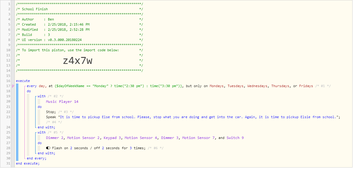

I have the attached piston. When I do a trace it appears that the expression is not considered when it decides when should be scheduled. Perhaps it is being considered but on the day that it is being considered it is not considering the next day so if it is considering Monday’s schedule on Sunday the day of the week is Sunday and it doesn’t schedule Monday’s schedule at 2:30. It would probably schedule Tuesday’s at 2:30.
For the piston to run Monday at 2:30 and Tuesday through Friday at 3:30.
I just confirmed it because it just ran now. It appears that it is considering the schedule an entire day ahead of time so so when it completed today on Monday and went to schedule it again it sees that it is Monday and it scheduled it to run tomorrow (Tuesday at 2:30). I can obviously fix this by checking the day of the week as Sunday but is there a better way to design this?
