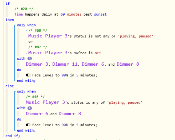

Can someone please help me figure out why this is causing my lights to turn on, when watching a movie on Plex, at 6:30 am?

on the question you asked, the else condition is executing causing dimmer 6 and dimmer 8 to come on.
As @bangali said, the “else” comes into play and switches the dimmers on no matter what & then starts dimming 'em again.
You need to add another check to only do do the fade ONLY when those 2 dimmers are ALREADY ON.
