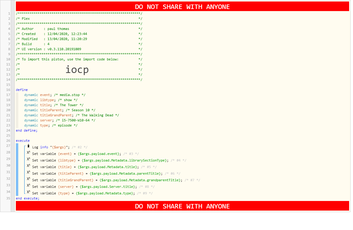

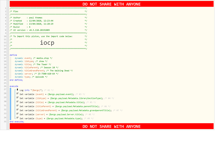

I’ve been looking into this, and managed to get it working for some requests. The attached piston correctly displays info received from Plex, I’ve not done anything with it yet. I’ve attached the ‘red’ version so you can see the values correctly set from a media.stop event.
As mentioned in the referenced post, there is an issue when plex includes the jpeg image, this is added when a media add, or play event is sent. I’ve raised an enhancement request with Plex, to optionally not send the jpeg when the webhook is called. If you can vote for it, it may get implmented.
