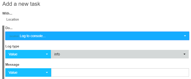

Try logging the contents of $args.Player.local
only started playing with this today. How do you log something?
Put {$args.Player.local} in the Message field.
do you need to “store it in messages”?
Not necessary for debugging.
