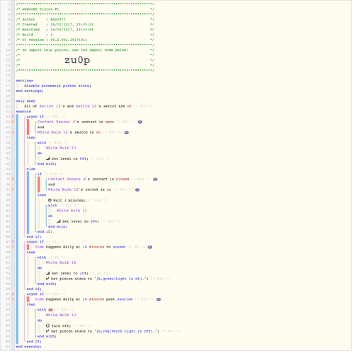

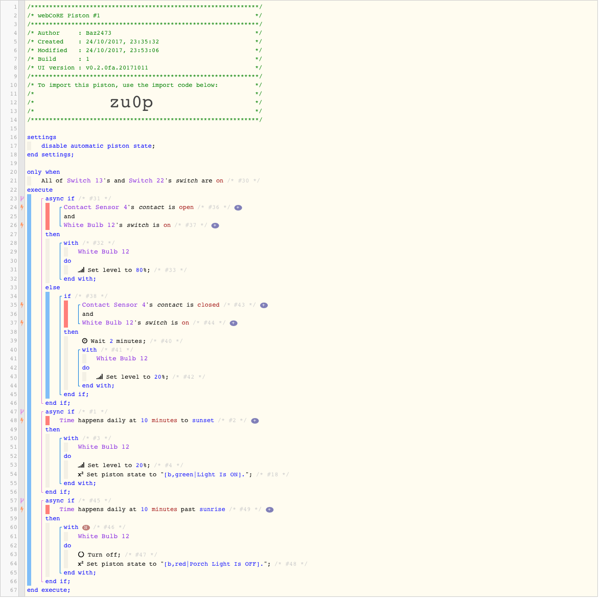

I have the porch light come on and off automatically. One of my pieces isn’t working
Light comes on at sunset+offset and off at sunrise etc. This works fine.
When front door is opened, porch light goes to 80% for 2 minutes then back
It goes up to 80% when door is opened, then when door is closed, it drops back down.
I’ve tried using door changes to open, changes from closed, door is opened. I’ve tried Never cancel on the timer piece, Allow multiple schedules and combinations thereof.
4) Post a Green Snapshot of the piston![image|45x37]
(UPLOAD YOUR IMAGE HERE)

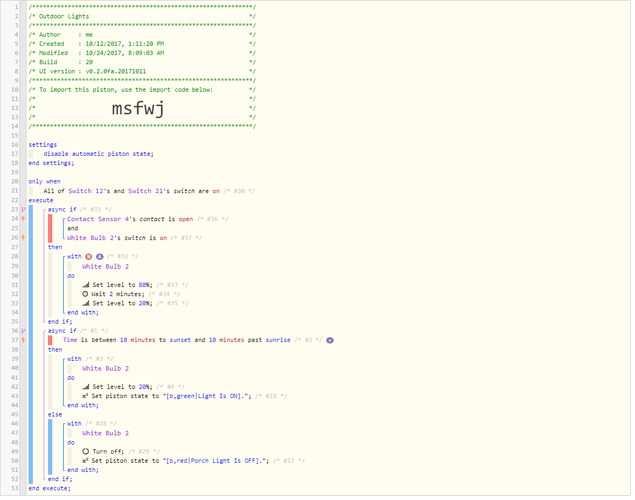

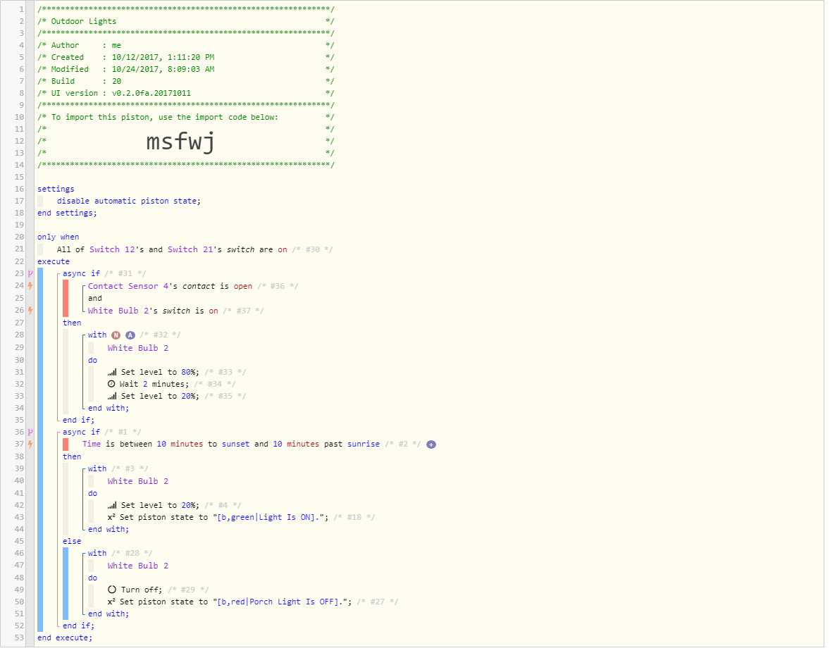

Give this a try. See how it goes :grinning:
I’ve added an extra bit so that if you are standing at the door chatting to someone for longer than 2 minutes the light won’t dim until 2 minutes after you close the door.
Also if you open it again before the 2 minutes are up it will cancel the countdown and wait until you close it again before it restarts the 2 minute countdown.
Please let me know how it goes.
The reason yours didn’t work as expected is because when you closed the door, that triggered a re-evaluation of the piston (because the door contact sensor was subscribed to) thus making it look again from the top down. It realised the door was closed (not open) and the light was on and the time was between the times you specified so it did what you asked it to do and dim down to 20%. That was your second If statement. The first statement was no longer true so it acted on your second If statements commands. You will also find that because you had tcp (task cancellation policy) set to Never Cancel it would have continued with the 2 minute countdown from the first if’s statement and dimmed it to 20% again if it were higher than 20% at the end of the first 2 minutes.
Sorry for the mouth full but I hope that helps you understand it a little better.
