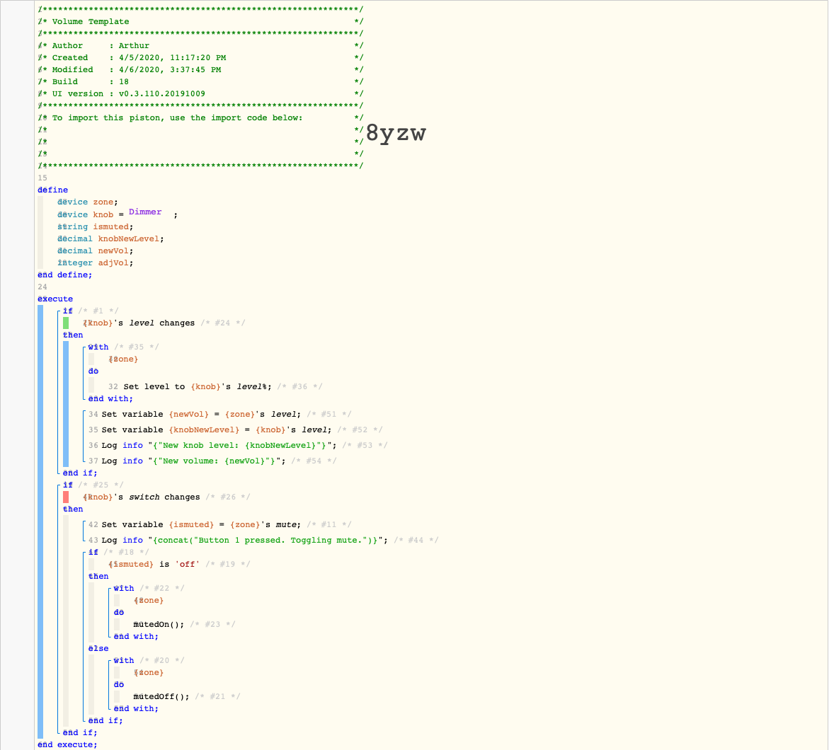

I’m using a piston to have any number of IKEA Symfonisk Controller knobs control volume for various home audio devices. When being rotated, the knobs send out repeated Zigbee events to indicate that they are in the process of being turned in one direction or the other. The piston looks for these changes and executes, aligning the volume with the level of the knob. There are a lot of events, so one of the piston executions will occasionally get stuck waiting at a semaphore (that part is expected), then trigger 10 seconds later, causing the volume to jump erratically back to some intermediate level.
I’d like to be able to abort any piston firing that gets stuck “waiting” to avoid weird jumpy behavior in volume.
For example (see logs), events fire that set the volume to 42, 39, 36, 33, then end at 30. The 39 event gets stuck waiting, but the 36, 33, and 30 events fire without issue. Then, 10 seconds later, once the semaphore wait is over, the 39 event fires and volume suddenly jumps back up to 39 from 30. Ideally, the 39 event could be aborted since subsequent events have eliminated the need for it to execute.
