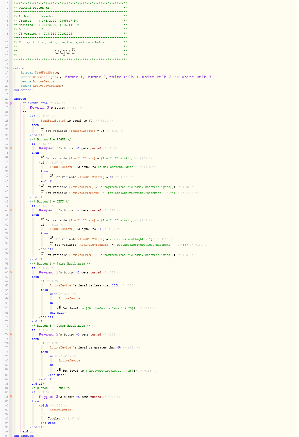

So…see the image for what I’m doing. It’s not done - the second array of names is to have the Echo in my basement announce what light you switched to.
Some of the issues I’m having though are:
  • There’s now way to order a device list it seems. So it’s the order you get…which kind of stinks.
  • I’d like to have a few scenes intermixed (e.g., TV Lighting, Movie Lighting, All Off) but I can’t figure out (yet) how to have that work directly with a scene - doing a virtual button I can do. But, again, this is suboptimal without being able to order the device list so all the scenes are ‘adjacent’ to each other.

First look, your piston looks pretty good.

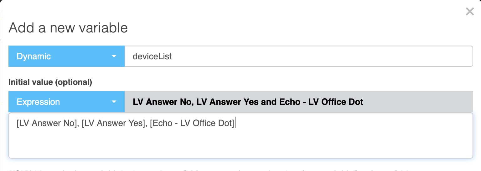

If you use an expression, you can enter the devices in any order you wish separated by commas.
The key when entering is start with the ‘[’ and then select from the pop-up list. It will insert a ‘:’ which you just delete and add the ‘]’. You can use this to create your device list in any order.

Very strange. I just did a quick test and don’t see either issue. I put 7 devices in a list and when I log to console, it does put an ‘and’ between the last two but when I do count(deviceList) I get 7. Also, when I convert to string (I just tried item 1 which is the second element) I don’t get a space. Perhaps post your latest piston and I will take a look.
