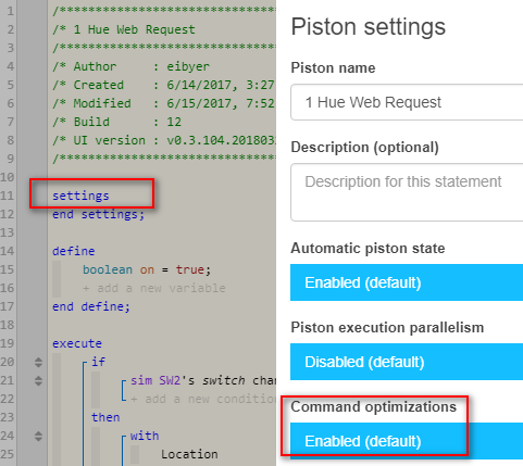

In your piston I would probably disable command optimizations if you have not done so already so webcore sends the off command regardless of what ST thinks it’s switch state is.

How do I disable command optimizations?
Thanks. I missed the cog menu for settings. For now, I will just leave it on executing with an “every”. I’d like something like this to work when I need it to, and that’s the only way I’ve gotten it to work, unless I am doing something wrong.
