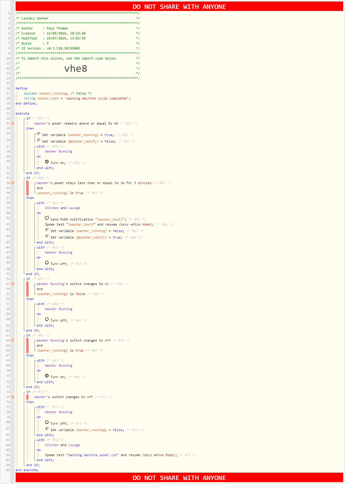

This is my piston, it has a few extras. The global is set so a separate piston can remind you when you walk into the laundry. It also covers resetting variables by powering off the socket.
