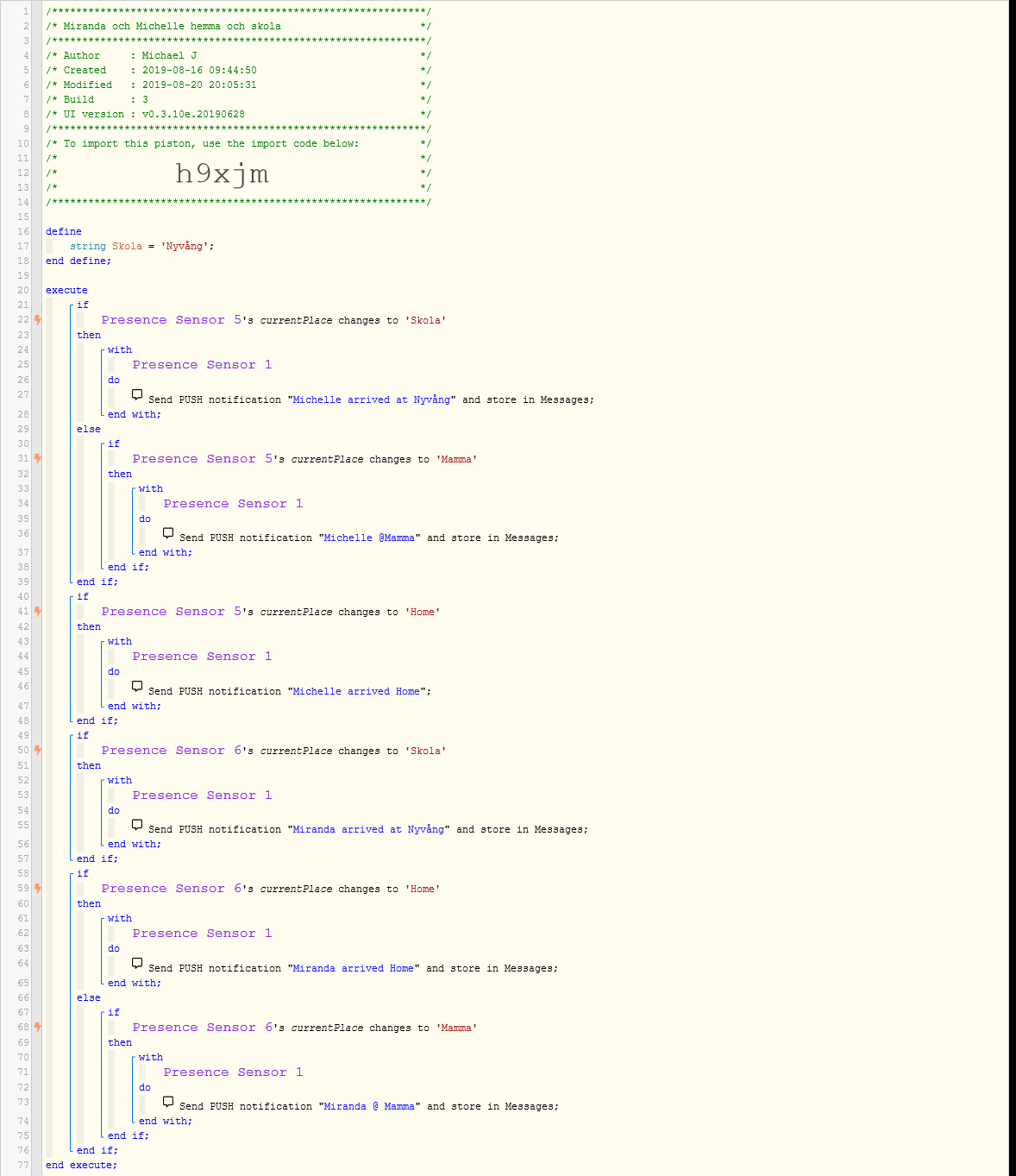

To give an push message when my daughters arrives either Home,Skola (School)or Mamma (mum)
gives intermittent push notifications , more often no notifications at all
No loggs

And try your piston without ELSE statements…
