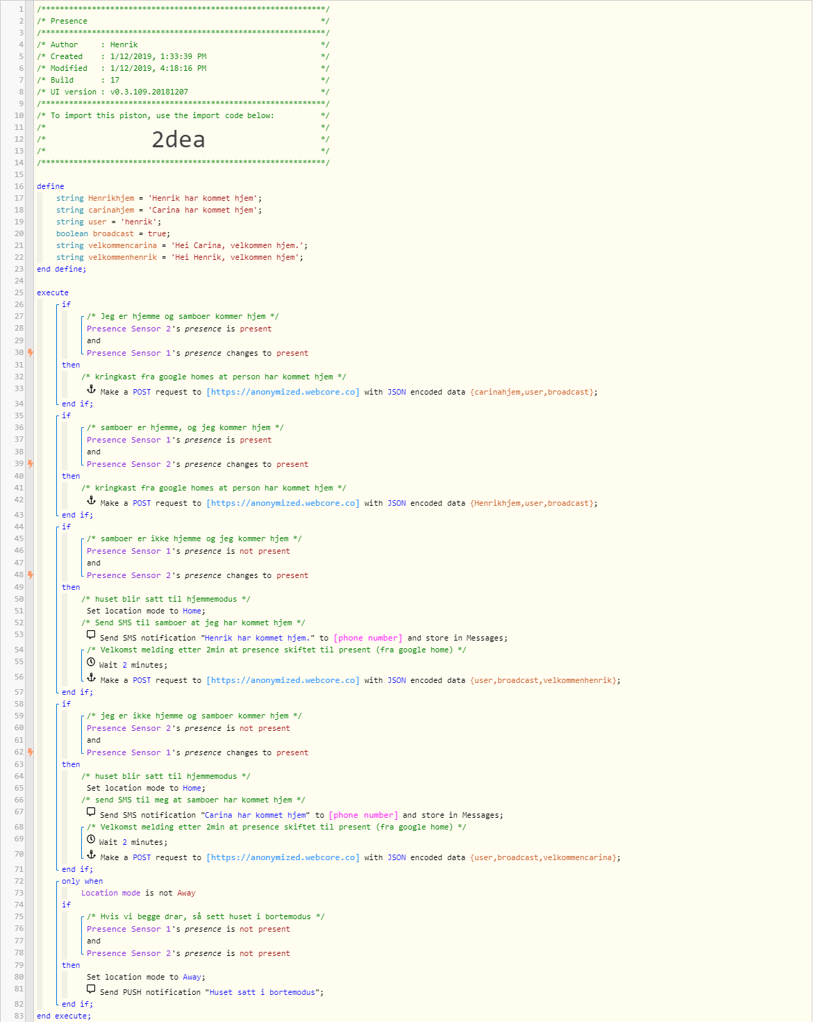

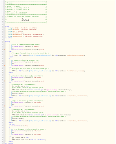

Got my hub v3 two days ago, changing over from Homey. I tried testing this flow with gf coming home, but it didnt trigger on the first part.
Basicly if
Im home and gf comes home -> then alert over google relay
Gf home and i come home -> then alert over google relay
I come home and gf not home -> set home mode, send text to GF and a welcome message relay (after 2 min)
Gf come home and im not home -> set home mode, send text to me, and welcome message to gf (after 2 min)
If we both have status away and mode is not away, set away
The part im home and gf comes didnt trigger when gf went from away to present just now.
