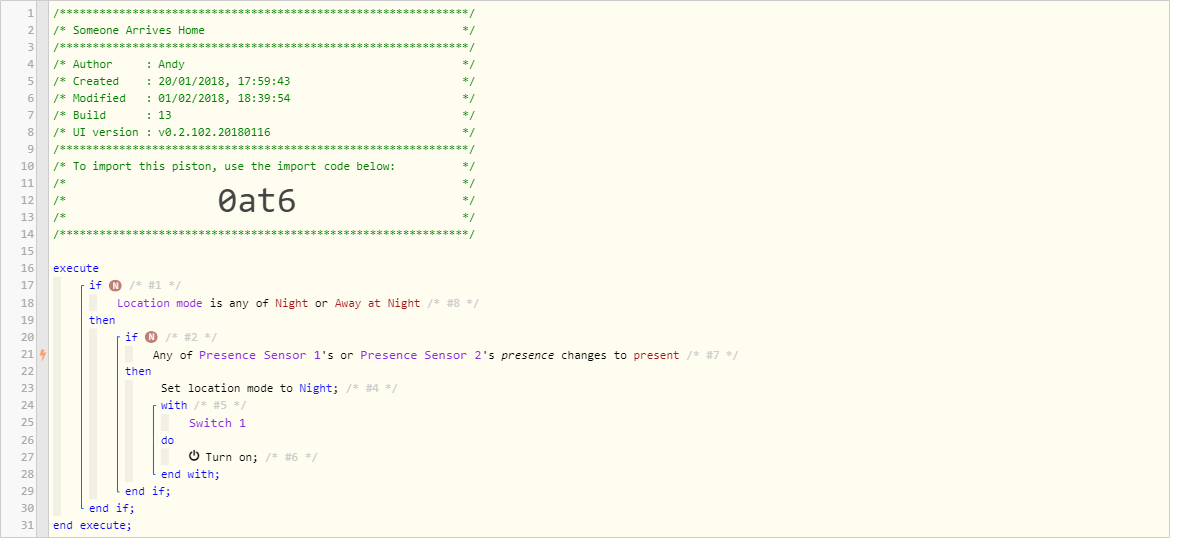

I have a simple piston which I intend on executing when I arrive home after dark. I have a piston which set the house state to be “Away at night” if I’m away from home after sunset. What I want to happen, is when one of the presence sensors switches to present, if the house is in a night mode (either “night”, or “away at night”) then the house state should switch to “night” (which is the trigger for my lights). Whats happening instead, is the house state doesn’t change because when the piston fires the presence sensor seems to evaluate as not present.
I figure that if the piston is triggered and its subscribed to events from either present sensor, it should be impossible for it to be triggered and not evaluate true for condition 7
The condition is evaluating to false, making me think I’m missing a key bit of information here!
This is from the webcore logs. Bolded line is the bit I don’t get. I figure the bit at 151ms is the house state check

|+151ms|║║Comparison (string) :09702fd4fb506a6c2cf8f8acc2662121: is_any_of (string) :97bf9e8ea752bbd2ed50f4b645cb43ae:,:09702fd4fb506a6c2cf8f8acc2662121: = true (2ms)|
|+152ms|║║Cancelling condition #8’s schedules…|
|+153ms|║║Condition #8 evaluated true (6ms)|
|+154ms|║║Cancelling condition #1’s schedules…|
|+155ms|║║Condition group #1 evaluated true (state changed) (8ms)|
|+164ms|║║Comparison (enum) present changes_to (string) present = false (1ms)|
|+165ms|║║Condition #7 evaluated false (8ms)|
|+166ms|║║Condition group #2 evaluated false (state did not change) (9ms)|
|+169ms|║╚Execution stage complete. (27ms)|
|+170ms|╚Event processed successfully (170ms)|
