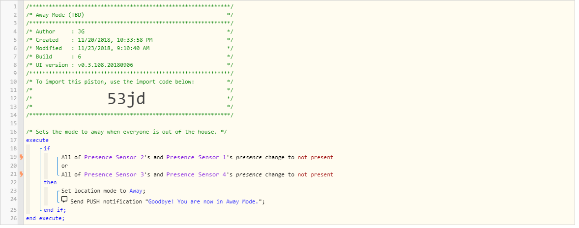

In the process of moving things from Core to WebCore, and nothing about this routine is working.
The intent is for the ST mode to switch to Away when both my wife and my phone are out of range, or when both of our presence sensors are out of range, and send a push message to the registered smartthings phones.
Mode is not changing. Push message is not sending.
5) Attach any logs
I don’t understand how to do this.
use is instead of changes to
Thanks so much. This was the fix. Unfortunately, now I am getting the push message sent twice. I assume this is because both or conditions are being satisfied? Is there a way around so that if both are true I only get one push message?
