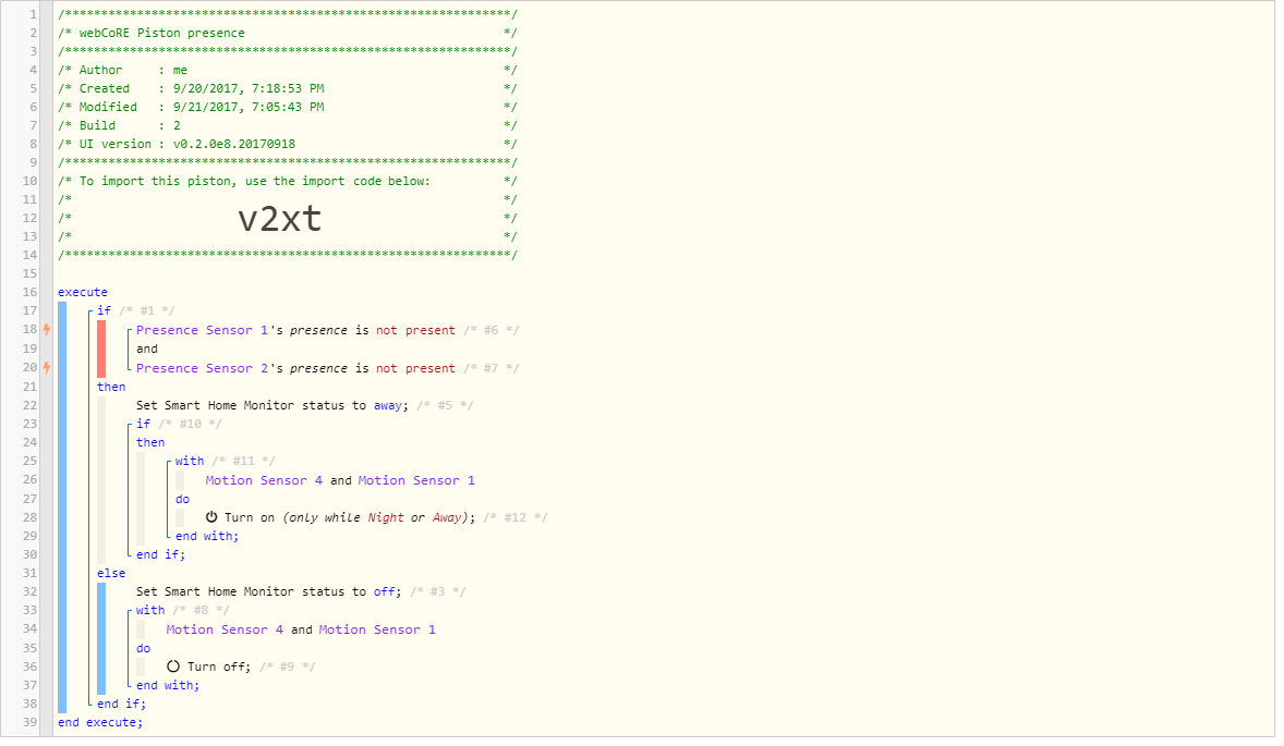

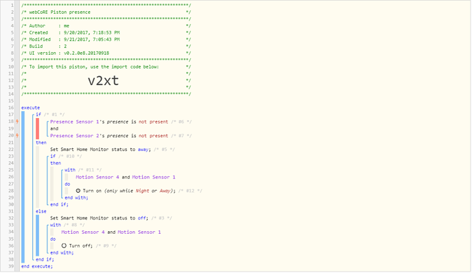

is this what you are asking about?
Yes … i have them connected via ST but SHM is quite unreliable at arming and disarming in relation to my presence sensors , half the time i have to disarm them manually via the app . It is a ST issue because my presence always states correctly in the app but ST doesn’t inform SHM correctly , so i’m looking at doing a WebCore piston to take over .
Basically i want SHM and cameras to be armed when we are away ( can do this bit without cameras) and disarmed when at least one of us has arrived home (this, either or bit confuses me in webcore ) At the moment i am ok with “if” and “then”, it’s all the other stuff , “variables” etc that stump me .
Ta
ahh, got it now.
keep at it, look at examples others are posting and you will be there in no time. :slight_smile:
if you get seriously stuck we are here.
will this do it ??
yep. just drag the with block at line 25 to outside the if block at line 23. THEN delete THAT if.
when you are done, whats under the if should look SIMILAR to whats under the else.

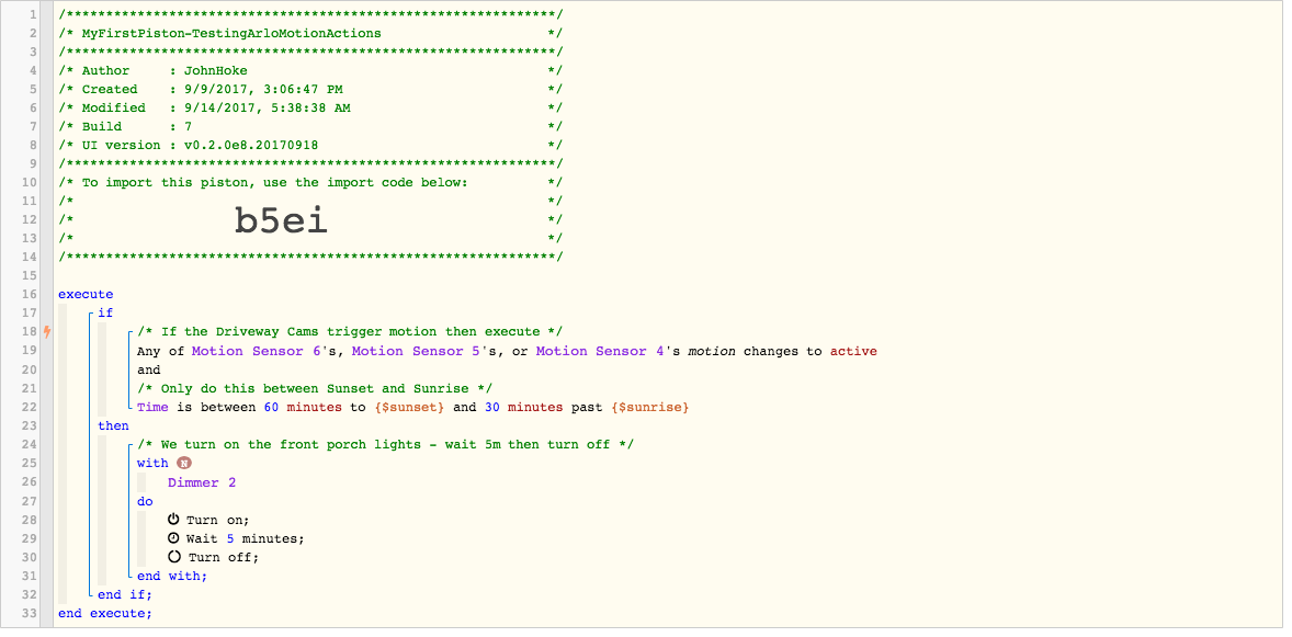

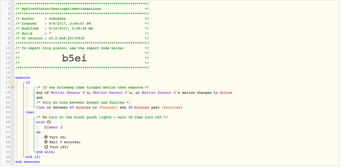

While not what you are trying to do, I have found that connecting Arlos to ST is ok… but Ive seen their names get all wonky time to time
This is the first piston I did when I installed WebCore … wanted a light to come on with motion detection on the arlos at night … I’m sure this could be more elegant and do other bits :wink:
The ‘motion sensors’ are actually arlos outside my home and the dimmer2 is a front porch light via caseta
EDIT - it does produce some nice videos of deer eating my front lawn LOL
