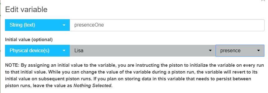

Define a string variable as something like presenceOne.
For the initial value, select Physical Device(s), select your presence 1 sensor, and “presence” as the information you want reported back…

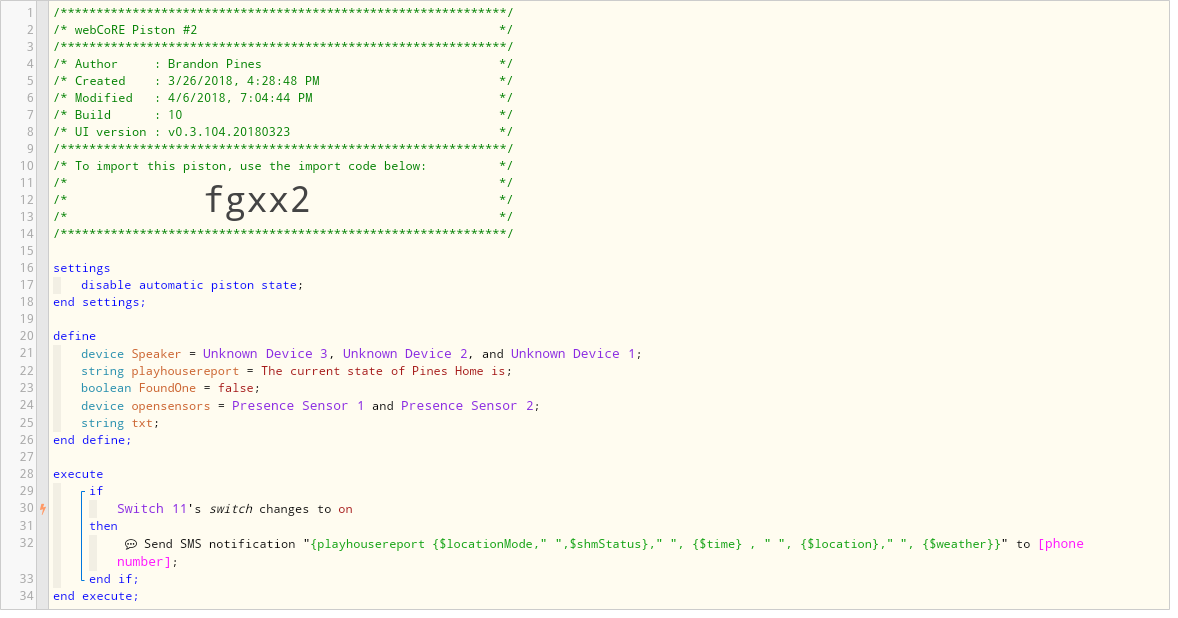

I used the following
{playhousereport}," “,{$locationMode},” “,{$shmStatus},” “,[presenceFamily: presence],” “,{$time},” ",{$weather}
I get The current state of Pines Home is: Home Disarmed present and present 2:33 P.M. null.
Why is weather null and can i get present and present to say the names + present or not present?

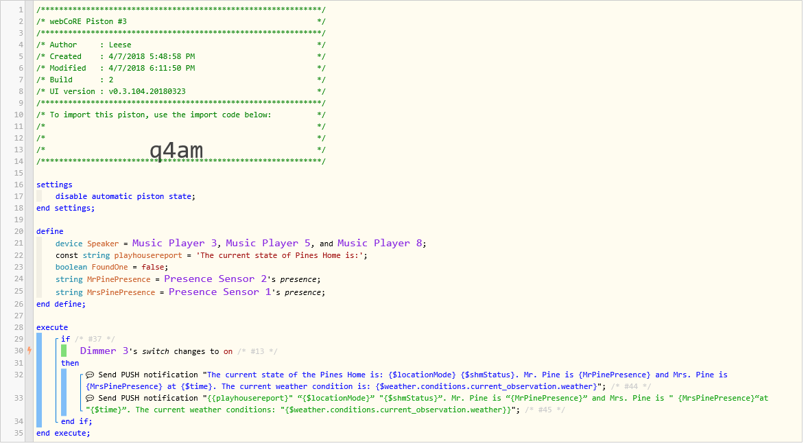

Try this. There are two ways to use variables in messages - through expressions or values.
For more info on the {$weather} variable, see this link.
I know it gives you double notifications. I was simply trying to show you different ways to use your variables. You can tweak that piston to give you only one.
