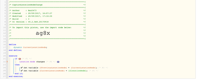

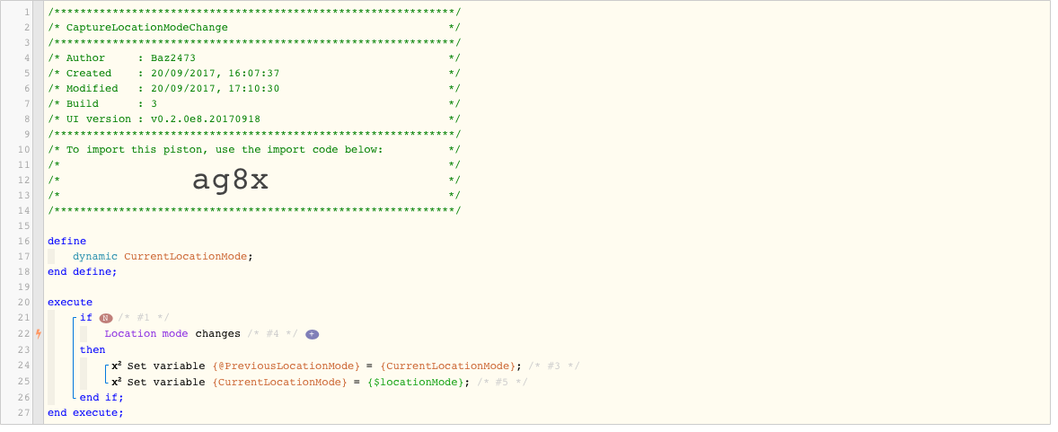

This might be better.
You will need to create a global variable named @PreviousLocationMode
And then import this piston.
And it won’t display correctly until after the first location change.
UPDATED.
