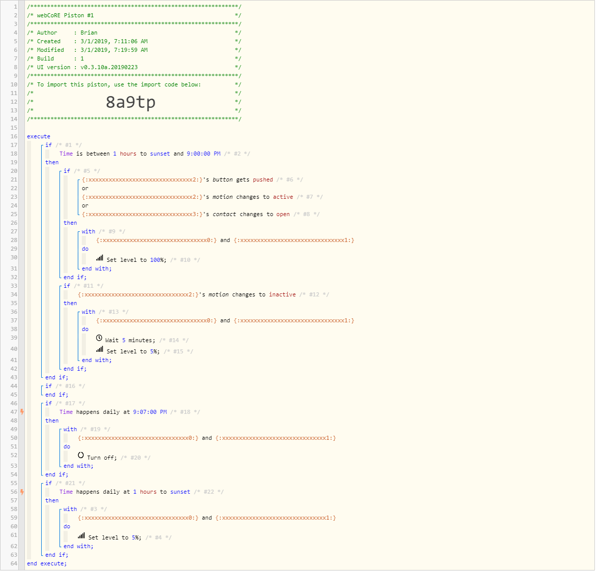

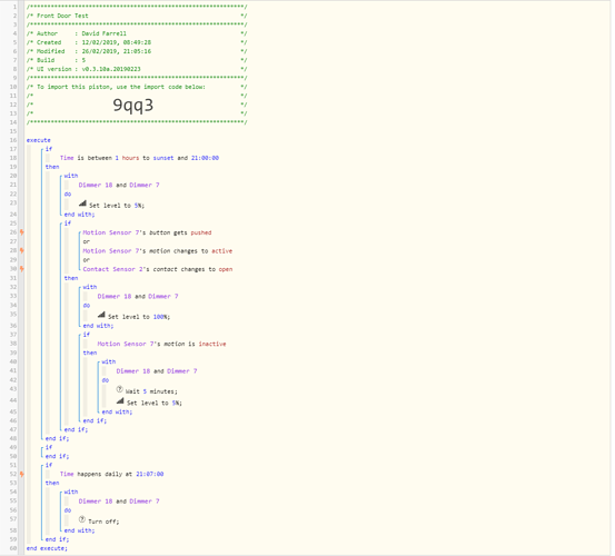

I have a piston that manages the front door lights but its not working as expected.
2 lights turn on 1 hour before sunset to 9pm.
But if there is motion or door open or ring the doorbell the lights go to 100% for 5 minutes and back to 5%.
But outside the 1 hour before sunset to 9pm the lights on motion or door open or ring the doorbell the lights go to 100% for 5 minutes and then turn off.
Lights don’t come on at 1 hour before sunset but turn off at
Lights go to 100% with motion or door open or ring the doorbell but turn off straight away when the motion goes to inactive or door closes.
