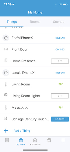

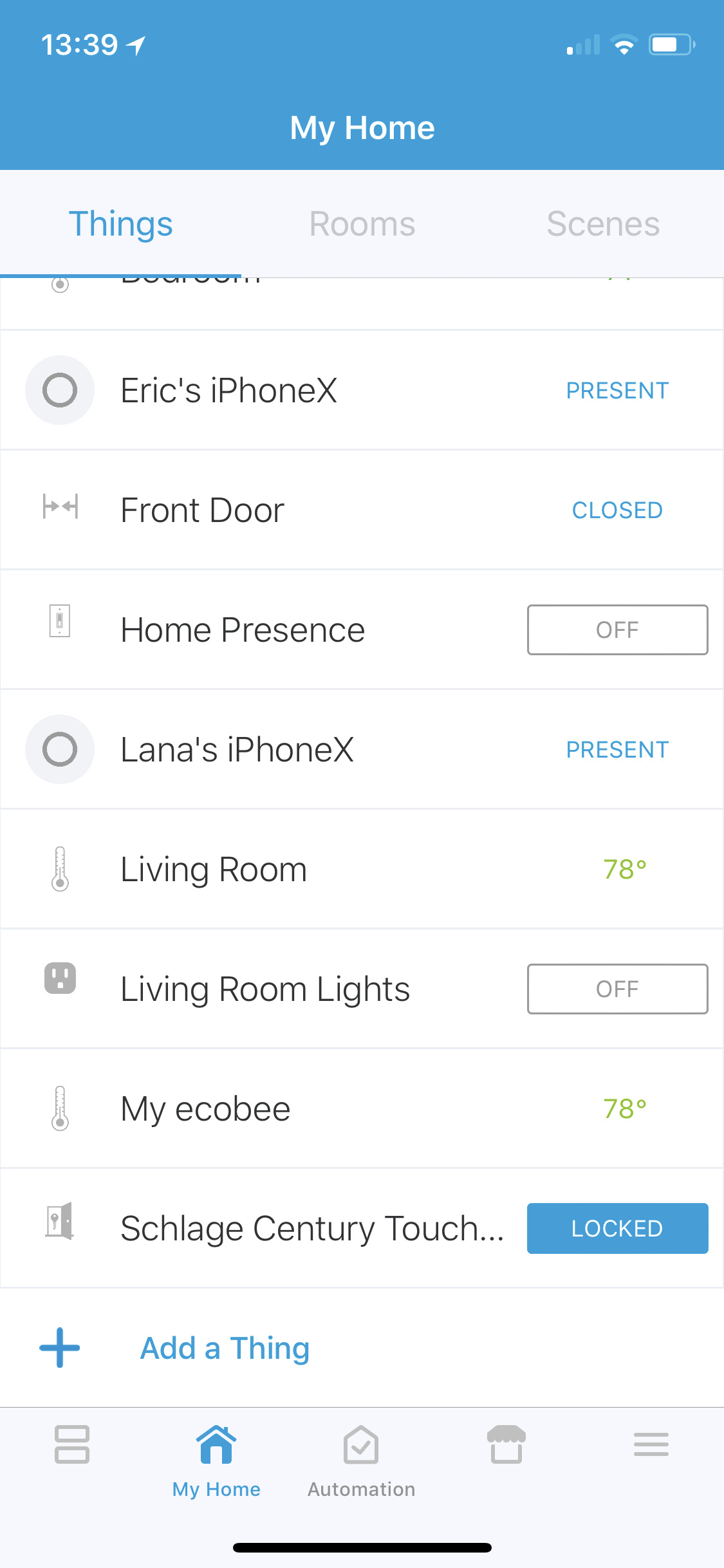

Piston Status of TP-Link Switch does NOT update properly in WebCoRE but does show properly (usually) within ST App
Status of Switch to show CORRECT on/off status in WebCoRE
Status is not updating one way or another, remains off, when on and off, then remains on when on and off.
Not sure where or how to get this, as the status IS updating in ST, but sometimes (maybe?) in WebCoRE
