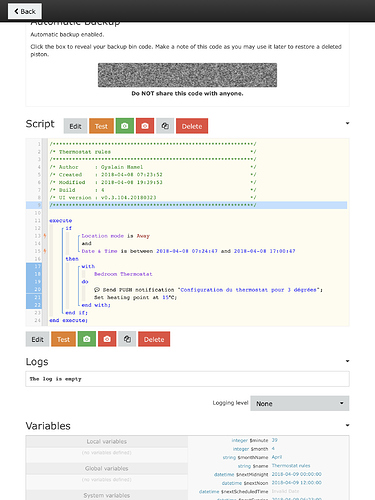

Ok so this is a test piston.
As you can see it says that if the house mode is away and between those time, to heat the thermostat to 15.
That works well.
My problem is this. Let say I’m at work and I think that 15 is too low. If I go modify the piston to exemple 17 it won’t work unless I change the location to night or home and then back to away.
Anyway to fix this?
after you change it to 17, click on the Test button.
And the goal is to get some logs?
No, it will run the piston if the conditions of the piston are true
Yeah but I want it to run automatically
why modify the piston? why not simply adjust the temp you want it to be on thermostat through ST?
I could, it’s just laziness, because if i modifiy the piston for the temperature, and then the ST then it’s 2 job, but it’s fine, was just wondering if there was another way
Thanks
Well i could do just something like Every minute, do this!
My real goal is to prevent people from playing with the thermostat.
