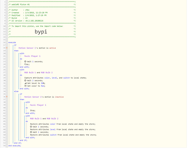

Save State is not working on lifx bulb
after the set action I would like the lights to return to the state they were in before the piston fired.
if the lights were off when it started, the turn back off. If they were on and say yellow. They stay red (the last color of the piston action)

I posted on smartthings and was directed here. So i am trying my luck here. I am new to webcore.
