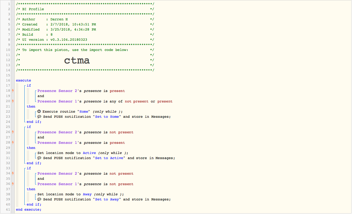

When I first set this up everything worked perfectly. Using the WC presence sensor on my iPhone and wifes iPhone. We would only get 1 notification per event.
We both upgraded our phones (iPhone x and iPhone 8) now the presence sensors are all over the place, sometime not sensing if we’ve left or arrived home. Also we are getting multiple notifications, sometime Active first then Home, or active first then away. This might be due to how I set it up but just not sure why it worked so well with our old phones (iPhone 6 and 6s) but now so much trouble…

+138ms ║╔Execution stage started
+152ms ║║Comparison (enum) present is (string) present = true (1ms)
+153ms ║║Condition #5 evaluated true (10ms)
+158ms ║║Comparison (enum) present is_any_of (string) not present,present = true (2ms)
+159ms ║║Condition #6 evaluated true (5ms)
+160ms ║║Condition group #1 evaluated true (state did not change) (17ms)
+162ms ║║Cancelling statement #2’s schedules…
+317ms ║║Executed virtual command executeRoutine (153ms)
+334ms ║║Executed virtual command sendPushNotification (13ms)
+343ms ║║Comparison (enum) present is (string) not present = false (1ms)
+344ms ║║Condition #17 evaluated false (7ms)
+345ms ║║Condition group #13 evaluated false (state did not change) (8ms)
+355ms ║║Comparison (enum) present is (string) not present = false (1ms)
+356ms ║║Condition #23 evaluated false (8ms)
+357ms ║║Condition group #19 evaluated false (state did not change) (10ms)
+359ms ║╚Execution stage complete. (221ms)
+360ms ╚Event processed successfully (360ms)
