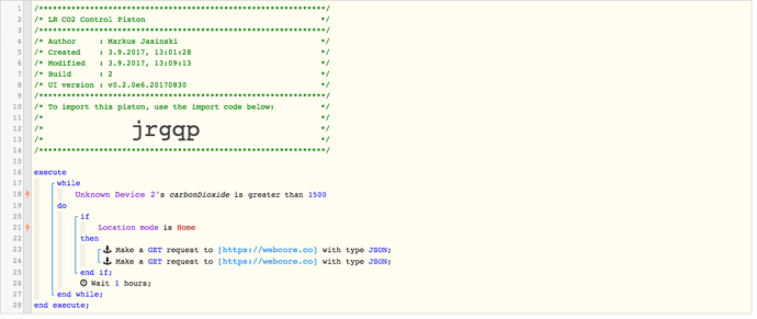

Hi, I designed a piston which should issue a carbon dioxide warning (source is a Netatmo sensor) to my Lametric display and my Sonos speaker every hour, if the CO2 concentration is above a certain level:
Basically the piston works, but the warning is issued every 10 minutes and not every 60 minutes as it should. Did I overlook something or designed it in a wrong way?
I’m grateful for any advice.
