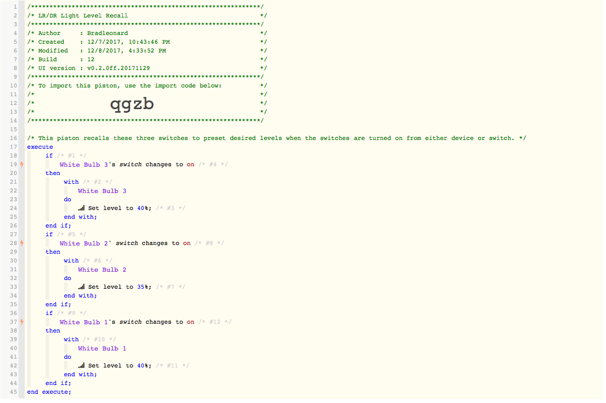

Programmed recall of switch light level
I would like to be able to have light switches turn on a preset level regardless of last setting when turned off. I have been able to achieve this with script pasted below, but this is slow enough that it is unusuable. It is recalling the level when the lights are turned rather than when they are turned off.
I would like to be able to set the recall level on the power down so that it turn on to the correct level with delay.
(PUT YOUR INFO HERE)
Click here to expand logs

this is not possible because none of the bulbs i know of allow setting level after they are turned of.
As @bangali mentioned, setting level to an off bulb will just result in the bulb turning on again.
Some devices have parameters which can be set to force a particular percentage brightness on switch on (i.e. Parameter 19 on a Fibaro Dimmer 2)… but many don’t.
You could experiment with the device handler, removing the turn on command from the set level section, but it’s unlikely to work.
