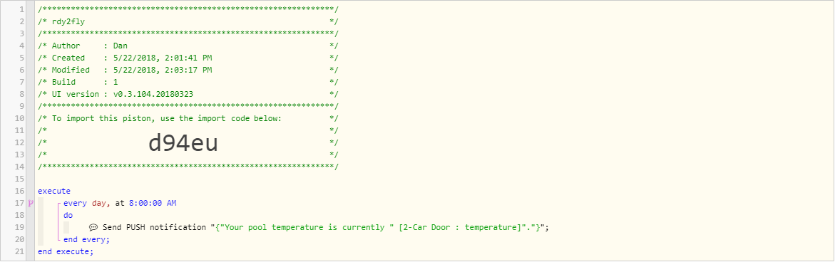

This should do it. Just adjust the time to the time and frequency you want to receive it, and change my 2-Car Door to the name of your temperature sensor.

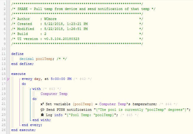

Well, michicago beat me to the post, but I had already started working on this, so here is my version. The main difference is I use a variable, and log the results, but the core concepts are the same.
(Import code is: ywk5)
temp
When you import this, just point it to your pool sensor when prompted.
