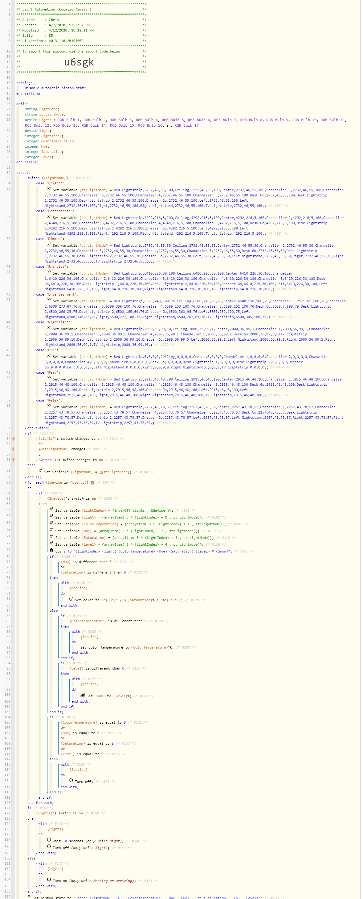

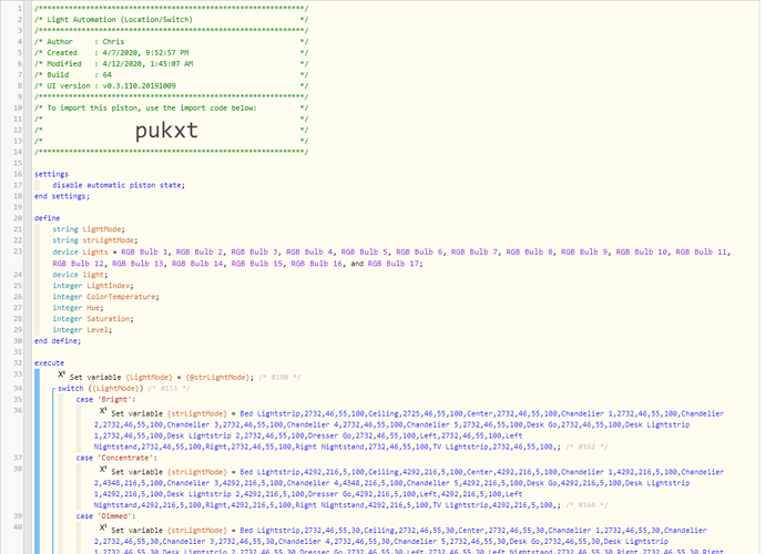

So this is a Piston I’ve been using just to figure out how to program it
dxk2
Im just confused on why it doesn’t work, I think the logic is the it just doesn’t find the right index and I’ve got no idea why but I’ll definitely try what you posted above
Thanks for the help, I don’t know why I was over complicating the hell out of it, but heres my somewhat final result.

I’m having some issues though with the last part, when the lights turn off during night. What im trying to do is preset the lights during the night mode so that the lights aren’t coming on at a high level but everytime the lights turn off it switches the scene to relax and some of the bulbs go on and off a couple of times. Do you have any idea what might be going on or why its now doing that?
If you look at the left-hand side of the image you posted, you’ll see the little lightning bolts indicating that a trigger is present in that line. You’ve got several. Each time one of those elements changes, the entire piston is going to re-evaluate. That can cause orphan lines like #33 to execute when it’s not intended, or cause parts of the piston (i.e., WAITs) that are already executing to be abandoned.
The biggest issue I see as I look at it again, is the section of code beginning with line 65. You’ve buried an IF statement with multiple triggers (lines 66 and 67) inside another IF statement. While I’m not as strict as some here when it comes to having triggers in multiple places in a single piston, nesting them is going to cause trouble 99.99% of the time.
The first thing I’d do is move that block under the ELSE (starting at line 65) to its own block. Then make absolutely sure that none of the actions under any of the SWITCH or IF blocks is causing one of the other blocks to execute.

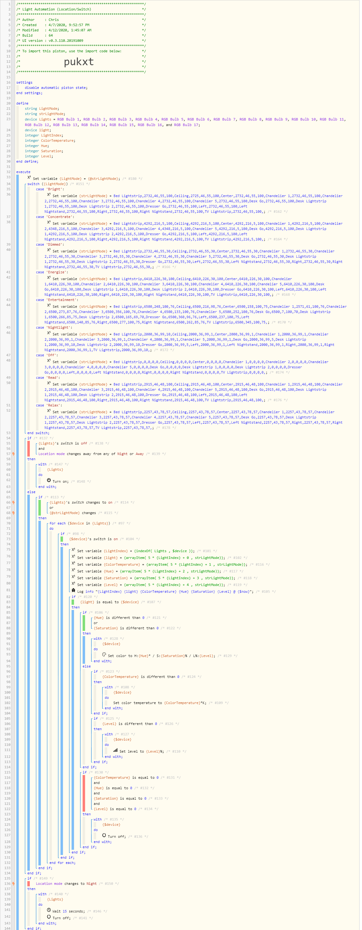

Yeah I’m still stumped, so far the part of the piston that sets the lights is good, the scenes are good, but whats throwing everything off and I don’t know the syntax of the time functions that well. What I’m trying to accomplish is that when location mode turns to night I want the lights to be set to nightlight and after they are all set to then turn off the lights. I think I know that I need to use either a wait, previous age, or a lockout function? And for when the the location mode is already night or away the lights should be off, and when changing to morning or arriving I want the lights to turn on. Here is my piston so far.
And I guess one last thing for now… hahaha is that I think the switch that is setting the scenes isn’t reading correctly. For instance I just ran the piston while set to home and it set to light mode to read but my calling variable is set to relax. I don’t know why its starting to do that now.
